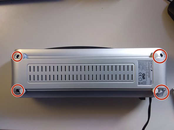

    1. Remove foil from laminating roller, Opening the housing: step 1, image 1 of 3 Remove foil from laminating roller, Opening the housing: step 1, image 2 of 3 Remove foil from laminating roller, Opening the housing: step 1, image 3 of 3
      • Remove the four PH2 screws on the bottom.
      • Unclip the top and bottom shells twice each at the front and back.

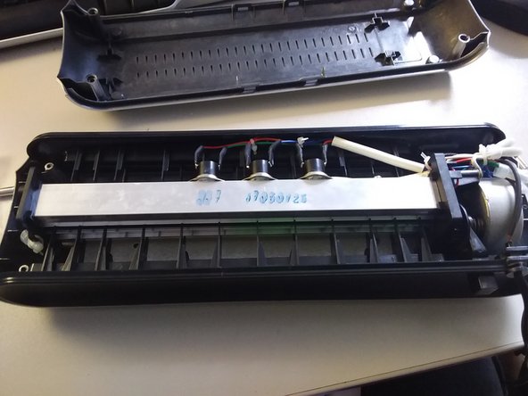

    2. Remove foil from laminating roller, Opening: step 2, image 1 of 1
      • Remove the case halves

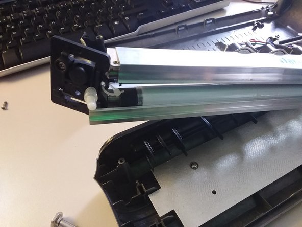

    3. Remove foil from laminating roller, Disassemble the mechanism: step 3, image 1 of 3 Remove foil from laminating roller, Disassemble the mechanism: step 3, image 2 of 3 Remove foil from laminating roller, Disassemble the mechanism: step 3, image 3 of 3
      • Remove the PH2 screw
      • Pull back the aluminum profile
      • Remove the roller
