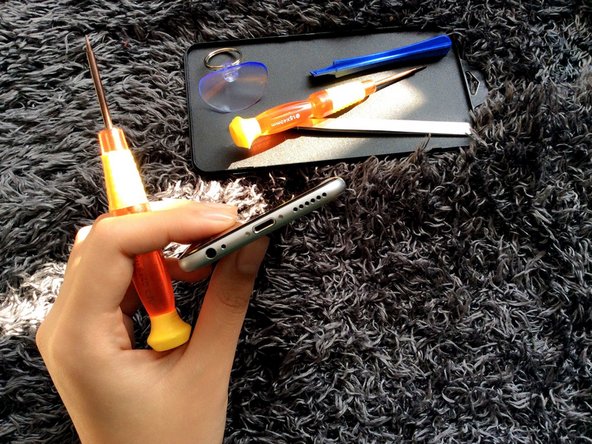

    1. Remove  iPhone 6 Plus LCD screen, Prepare the maintenance tools: step 1, image 1 of 1
      • Prepare the tools to be used for maintenance
      Ask FixBot
    2. Remove  iPhone 6 Plus LCD screen, Shut down and remove the bottom screw: step 2, image 1 of 1
      • Shut down the phone and remove the bottom screw

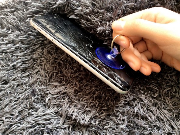

    3. Remove  iPhone 6 Plus LCD screen, Suck up the LCD screen: step 3, image 1 of 1
      • With the suction cup to suck up the LCD screen
      Ask FixBot

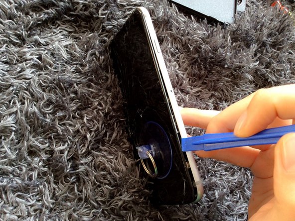

    4. Remove  iPhone 6 Plus LCD screen, Alice stick with the screen out of the three sides: step 4, image 1 of 2 Remove  iPhone 6 Plus LCD screen, Alice stick with the screen out of the three sides: step 4, image 2 of 2
      • Alice stick with the screen out of the three sides,gently pull down the screen ,and then you can open the screen.
      Ask FixBot

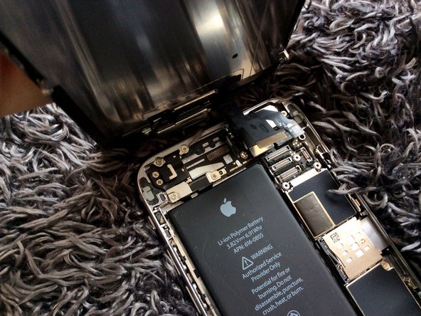

    6. Remove  iPhone 6 Plus LCD screen, Unplug the four cable, separate  screen: step 6, image 1 of 2 Remove  iPhone 6 Plus LCD screen, Unplug the four cable, separate  screen: step 6, image 2 of 2
      • Unplug the four cable, separate screen
      Ask FixBot

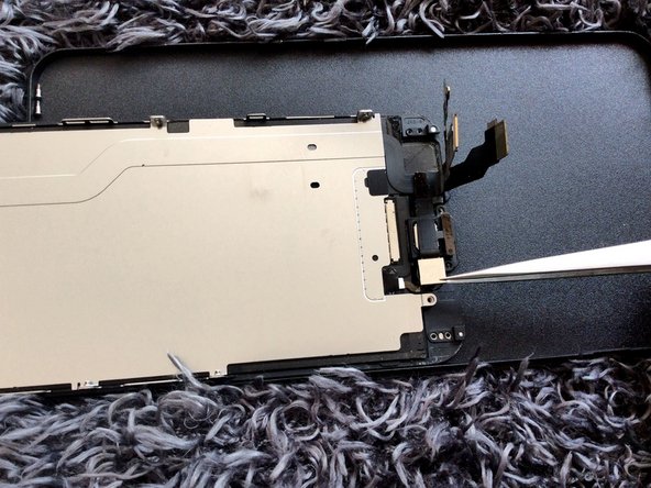

    7. Remove  iPhone 6 Plus LCD screen, Remove the cover of the front camera and the earpiece: step 7, image 1 of 1
      • Remove the cover of the front camera and the earpiece. Screw position is still in the distance without interference as the original place away.
      Ask FixBot
    8. Remove  iPhone 6 Plus LCD screen, Unplug the front camera and remove the handset: step 8, image 1 of 2 Remove  iPhone 6 Plus LCD screen, Unplug the front camera and remove the handset: step 8, image 2 of 2
      • Unplug the front camera and remove the handset
