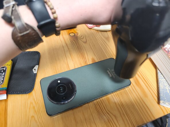

    2. Redmi A3 Screen Replacement, Heat the adhesive: step 2, image 1 of 1
      • Heat the edges of the back cover and the area of the camera cover using your heat gun, heating pad, or hair dryer
      • If using a hair dryer, be careful, because it's obviously quite imprecise
      Ask FixBot

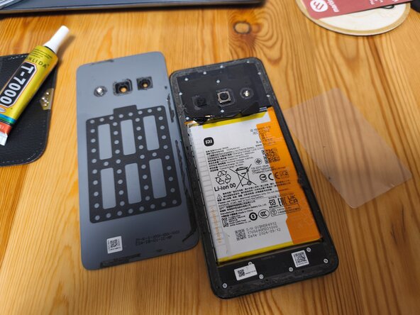

    3. Redmi A3 Screen Replacement, Pry open the back cover: step 3, image 1 of 1
      • Insert a thin piece of plastic under the back cover and pry it open by dragging the plastic around the edges and carefully under the camera cover
      • If the adhesive is too tough, heat it up again
      Ask FixBot
    4. Redmi A3 Screen Replacement, Remove back cover: step 4, image 1 of 1
      • Carefully remove the back cover of your phone
      • If the back cover is glass, it's better to use a suction cup or a piece of duct tape to avoid cracking
      • Remove the remaining adhesive using adhesive remover or by carefully scraping it off (I forgot to do that initially)
      Ask FixBot

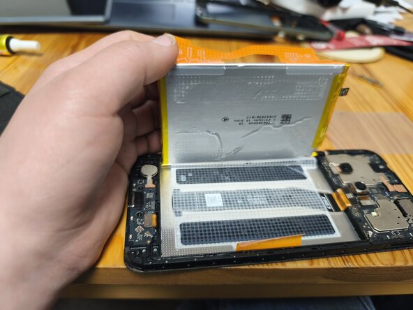

    7. Redmi A3 Screen Replacement, Remove battery: step 7, image 1 of 3 Redmi A3 Screen Replacement, Remove battery: step 7, image 2 of 3 Redmi A3 Screen Replacement, Remove battery: step 7, image 3 of 3
      • Disconnect the battery (you can do it with your fingers, I'm just using the screwdriver as a pointer)
      • This is a bit tricky: the orange sticker on the battery is separated into two parts labelled A (sides) and B (middle). Peel off the sticker and pull on A
      • Remove the battery with the rest of the sticker. Do not throw the sticker away
