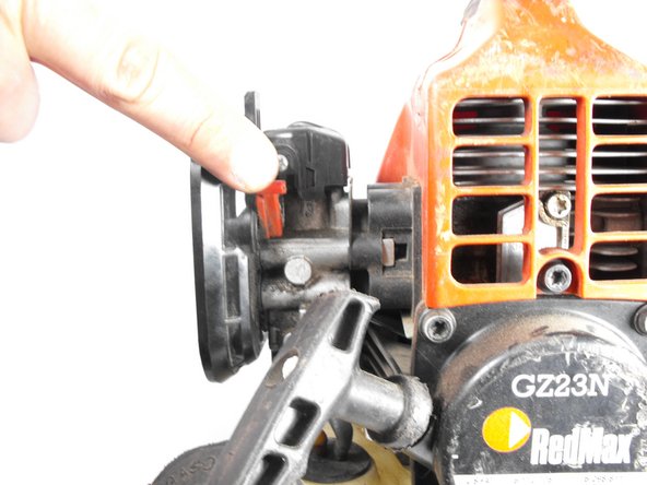

    3. RedMax Trimmer Carburetor Replacement: step 3, image 1 of 3 RedMax Trimmer Carburetor Replacement: step 3, image 2 of 3 RedMax Trimmer Carburetor Replacement: step 3, image 3 of 3
      • The red panel hides a second screw. In order to expose it, locate the red choke lever on the right side of the air filter housing.
      • Push the red choke lever down.

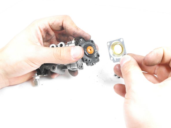

    6. RedMax Trimmer Carburetor Replacement: step 6, image 1 of 3 RedMax Trimmer Carburetor Replacement: step 6, image 2 of 3 RedMax Trimmer Carburetor Replacement: step 6, image 3 of 3
      • Unscrew the four 24 mm long screws that hold the carburetor together, using the #1 Phillips head screw driver.
      • Once the screws are removed, the rest of the carburetor should separate easily.
      Ask FixBot
    7. RedMax Trimmer Carburetor Replacement: step 7, image 1 of 3 RedMax Trimmer Carburetor Replacement: step 7, image 2 of 3 RedMax Trimmer Carburetor Replacement: step 7, image 3 of 3
      • Carefully remove the gaskets and carburetor and replace them in the same order that they were removed.
