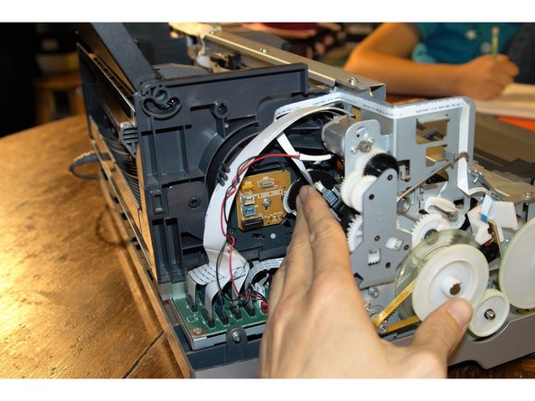

    9. Rebuilding the ASF Assy, Left side disconnects: step 9, image 1 of 3 Rebuilding the ASF Assy, Left side disconnects: step 9, image 2 of 3 Rebuilding the ASF Assy, Left side disconnects: step 9, image 3 of 3
      • Disconnect the FFC (flat flexible cable) (which links the main board to the relay board) at CN1
      • Disconnect the Paper Edge sensor at CN2
      • Disconnect the APG (automatic paper guide?) sensors at CN4 and CN5.
      • Disconnect the FFC which links the Paper Feed Encoder to the relay board at CN6. The Paper Feed Encoder's FFC is also tacked to the Sheet Feeder by double sided tape. Carefully separate the cable from the Sheet Feeder's frame.
      • Deroute the red & black APG motor wires from the ASF (automatic sheet feeder) housing.
      • Deroute the Flat Flexible Cables from the groove in the Automatic Sheet Feeder housing.

I am impressed by the quality of the instructions and photos. But do not why the ASF had to be removed. Is it to add a replacment? My concern is that my printer won't load paper. I am wondering whether I just need to increase the pressure on the pickup roller. With my printer the ASF mechanism is working it does try to pick up the paper.
ed - Reply Share
*sigh* Well you can see it takes me a while to get back to working on projects that I start. Anyway, the reason I was taking out the sheet feeder was that the sheet feeder builds up too much friction which the printer doesn't like and causes the sheet of paper to be ejected without printing anything. By removing it, lubricating it, and fixing the rubber bits; the printer will print again. My fault was that I haven't finished writing the guide yet.
