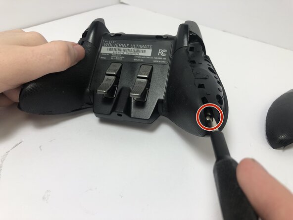

    2. Razer Wolverine Ultimate Back Panel Replacement: step 2, image 1 of 2 Razer Wolverine Ultimate Back Panel Replacement: step 2, image 2 of 2
      • Remove two 2 mm screws on the back of each grip using a T5 Torx screwdriver.
