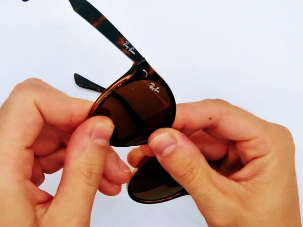

    1. Ray-Ban Round RB2180 Lens Replacement, Push the old lens out: step 1, image 1 of 1
      • Work over a soft, light-coloured cloth on a clear table, so that a lens is not scratched if it drops.
      • Open the temple arms and hold the frame by the rim of the lens you are removing, with the inside of the frame facing you.
      • Flex the rim gently with your fingers and, at the same time, push the inner surface of the lens with the pad of your thumb, near the edge. The lens comes out of the groove at that point first; then ease the rest of it out of the rim.
      • Use the pad of your thumb, not your fingernail, and do not lever the lens with a screwdriver or any metal tool. Flex the acetate only as much as needed: an old or cold frame is less flexible.
      • Optional: if the frame feels very stiff, warm the front for a few moments in water at about 40 °C (warm, but comfortable to the touch) or with a hair dryer on a low setting, keeping it moving. Dry the frame before you continue.
