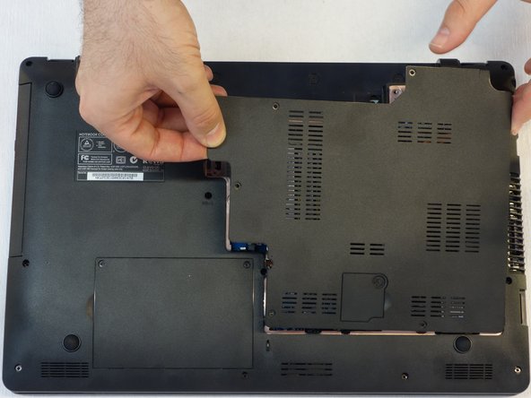

    2. RAM memory replacement for why! W253EU: step 3, image 1 of 3 RAM memory replacement for why! W253EU: step 3, image 2 of 3 RAM memory replacement for why! W253EU: step 3, image 3 of 3
      • Push the screwdriver a few millimeters under the cover so that it can be touched with your fingers.
      • Now lift the cover carefully.
      • Attention! Disconnect the ventillator cable so that the cover can be completely removed (see next step).
      Ask FixBot
    3. RAM memory replacement for why! W253EU: step 4, image 1 of 1
      • Since the ventillator is mounted under the cover, its power supply cable must first be disconnected so that the cover can then be completely removed.

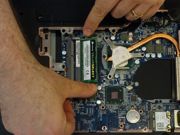

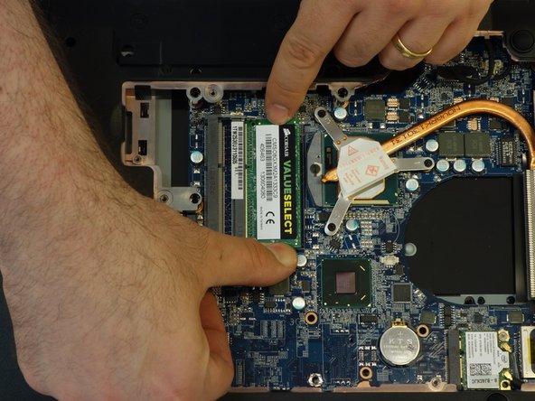

    1. RAM memory replacement for why! W253EU, RAM memory: step 5, image 1 of 3 RAM memory replacement for why! W253EU, RAM memory: step 5, image 2 of 3 RAM memory replacement for why! W253EU, RAM memory: step 5, image 3 of 3
      • Locate the two memory modules.
      • Release the locking spring on both sides of the module.
      • Now lift the module with its connector slightly.
      Ask FixBot
    2. RAM memory replacement for why! W253EU: step 6, image 1 of 1
      • Now remove the module from its connector by pulling it out symmetrically to its axis.
      • If necessary, repeat the procedure from the previous step with the second module.
      • Attention: the two memory modules must be identical, mainly in terms of their memory capacity!
