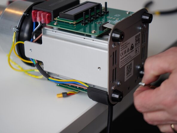

  4. Private Kaffelogic Nano 7/LINK (D-P Serial) Mainboard Replacement, Removing the rear panel: step 4, image 1 of 3 Private Kaffelogic Nano 7/LINK (D-P Serial) Mainboard Replacement, Removing the rear panel: step 4, image 2 of 3 Private Kaffelogic Nano 7/LINK (D-P Serial) Mainboard Replacement, Removing the rear panel: step 4, image 3 of 3
    • Remove the last 2.5mm Hex screw securing the rear panel.
    • Pull up on the rear panel to remove it from the roaster.

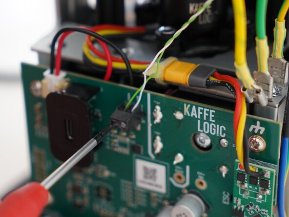

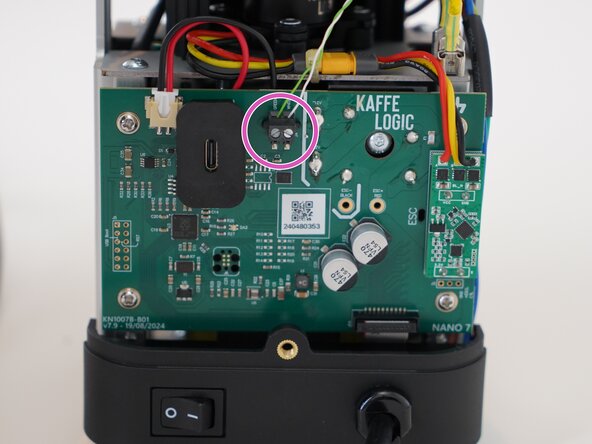

  6. Private Kaffelogic Nano 7/LINK (D-P Serial) Mainboard Replacement, Disconnect the thermocouple: step 6, image 1 of 3 Private Kaffelogic Nano 7/LINK (D-P Serial) Mainboard Replacement, Disconnect the thermocouple: step 6, image 2 of 3 Private Kaffelogic Nano 7/LINK (D-P Serial) Mainboard Replacement, Disconnect the thermocouple: step 6, image 3 of 3
    • Use a 2.0mm slotted screwdriver to remove the thermocouple wires from the PCB-A

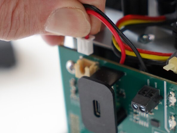

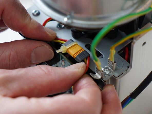

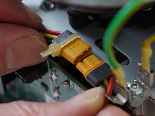

  7. Private Kaffelogic Nano 7/LINK (D-P Serial) Mainboard Replacement, Disconnect the motor: step 7, image 1 of 2 Private Kaffelogic Nano 7/LINK (D-P Serial) Mainboard Replacement, Disconnect the motor: step 7, image 2 of 2
    • Disconnect the motor cable, this may take some wiggling.
    • Refrain from using pliers or metal tools on this connector, as the plastic insulation can be damaged.

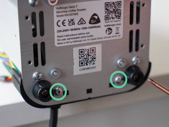

  9. Private Kaffelogic Nano 7/LINK (D-P Serial) Mainboard Replacement, Remove the cable carrier: step 9, image 1 of 3 Private Kaffelogic Nano 7/LINK (D-P Serial) Mainboard Replacement, Remove the cable carrier: step 9, image 2 of 3 Private Kaffelogic Nano 7/LINK (D-P Serial) Mainboard Replacement, Remove the cable carrier: step 9, image 3 of 3
    • Remove the 2x 2.5mm Hex screws securing the cable carrier to the base.
    • Be careful not to lay the roaster on its front as the buttons can be damaged or broken off.

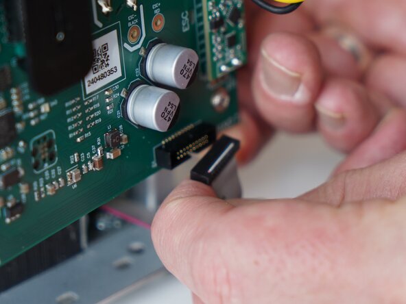

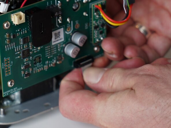

  10. Private Kaffelogic Nano 7/LINK (D-P Serial) Mainboard Replacement, Remove the ribbon connector: step 10, image 1 of 2 Private Kaffelogic Nano 7/LINK (D-P Serial) Mainboard Replacement, Remove the ribbon connector: step 10, image 2 of 2
    • Gently remove the ribbon connector.

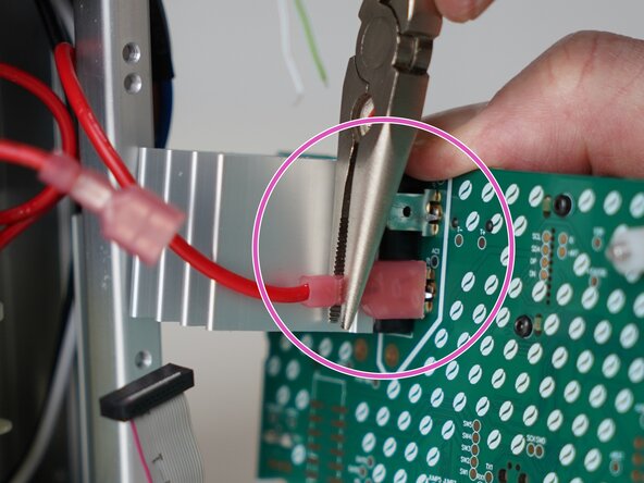

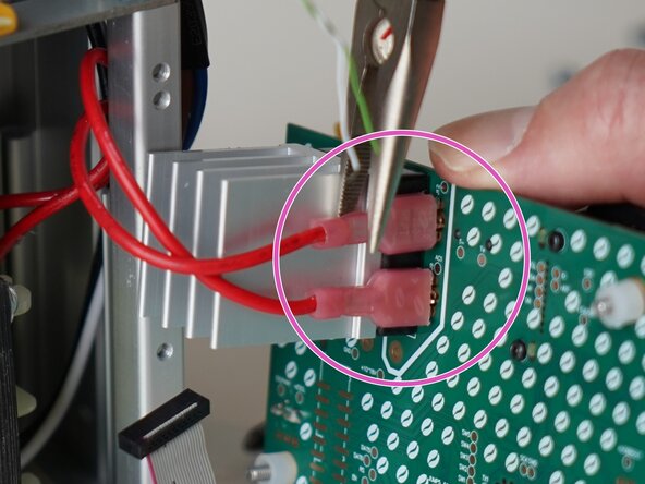

  12. Private Kaffelogic Nano 7/LINK (D-P Serial) Mainboard Replacement, Remove the PCB: step 12, image 1 of 3 Private Kaffelogic Nano 7/LINK (D-P Serial) Mainboard Replacement, Remove the PCB: step 12, image 2 of 3 Private Kaffelogic Nano 7/LINK (D-P Serial) Mainboard Replacement, Remove the PCB: step 12, image 3 of 3
    • Pull the PCB away from the base assembly.
    • Use pliers to disconnect the transformer secondary wires from the back of the PCB
    • The transformer wires may be reconnected in either orientation. If you are replacing the USB daughterboard, you can choose to leave these wires in place.
