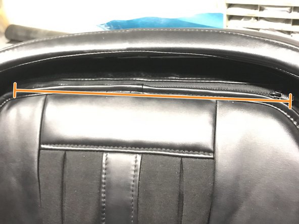

    3. Presidential 2.0  Roller Arm Replacement: step 3, image 1 of 3 Presidential 2.0  Roller Arm Replacement: step 3, image 2 of 3 Presidential 2.0  Roller Arm Replacement: step 3, image 3 of 3
      • Unzip Both left and right zippers . These zippers are found in between the shoulder airbag and back cushion.
      • see last photo for what end result should look like.

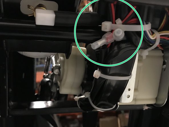

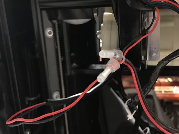

      • You will need to follow the heating element wire to the back side of the mechanism .
      • Wires are bundled in the marked area . Please cut all zip ties nessecary to access these wires.
      • These Wires do not use connectors they are capped together and share a connection with the opposing roller arm . Please cut , strip and re cap wires accordingly .

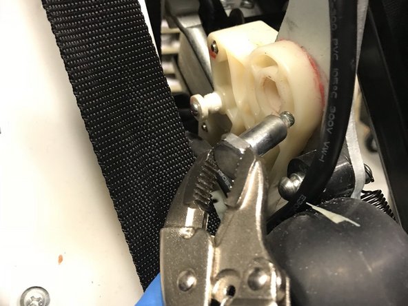

      • remove nut using a wrench . There should also be a small washer but they usually get stuck inside , they should fall out during the next step.
      • Next this bolt will need to be tapped out . you can either LIGHTLY tap it with a wrench from the threaded end ( see last step) or you can use vice grips .
      • Once Bolt is removed the arm is now loose . It may require some hand force to detach it from the assembly .
      • Beware if you are working on the right side roller arm ( sitting position) there will be an extra sensor that needs to be unplugged
