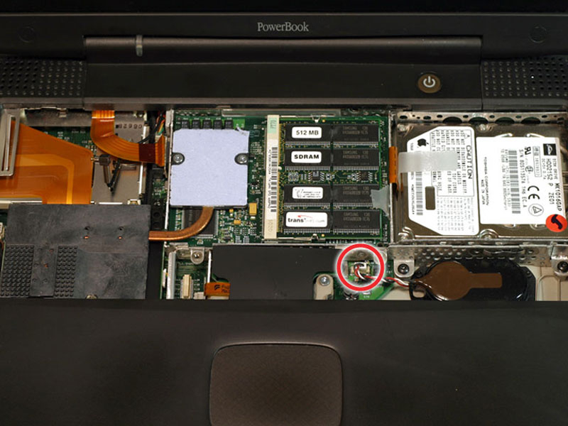

    1. PowerBook G3 Pismo PRAM Battery Replacement, PRAM Battery: step 8, image 1 of 1
      • Pull the battery cable directly up from the logic board.
      • Remove the battery from its holder by pulling up and to the left.
      Ask FixBot
    2. PowerBook G3 Pismo PRAM Battery Replacement: step 9, image 1 of 1
      • Your laptop should look approximately like this.
      Ask FixBot

Frankly speaking I do not have idea why do I need steps 2-7 to replace battery? Why I can't go directly to step 8 if it is possible? BTW - the battery seems to be composed from 4 standard batteries. Is anyone aware how to assembly new battery? It is not available as spare part (616-0108)
Tomek - Reply Share
Agreed, I just successfully removed my PRAM battery skipping all those steps, just popped the keyboard out, removed the DVD drive from the right-hand out and popped that bad boy out, no problemo.
Edward Gain - Reply Share
