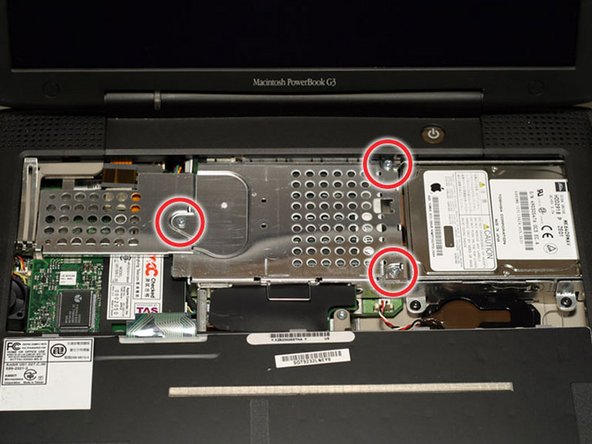

      • Turn the computer so that the ports are facing you.
      • If the keyboard is locked, open the port cover and turn the keyboard locking screw until the keyboard is unlocked.

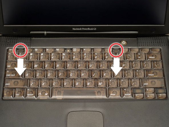

    2. PowerBook G3 Lombard PRAM Battery Replacement: step 2, image 1 of 1
      • Pull the keyboard release tabs toward you and lift up on the keyboard until it pops free.
      • Make sure you have removed the laptop battery and CD/DVD module from the expansion bays before proceeding.

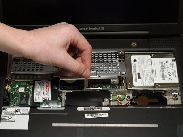

    3. PowerBook G3 Lombard PRAM Battery Replacement: step 3, image 1 of 1
      • Lift the keyboard out by pulling it up and away from you. Rest the keyboard, face down, on top of the trackpad.
      • In order to replace the keyboard, you must first remove the modem.

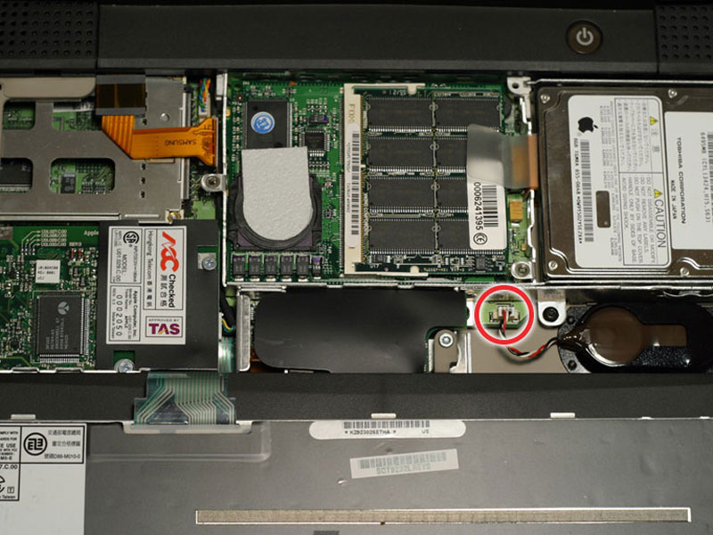

    1. PowerBook G3 Lombard PRAM Battery Replacement, PRAM Battery: step 4, image 1 of 1
      • Pull the battery cable directly up from the logic board.

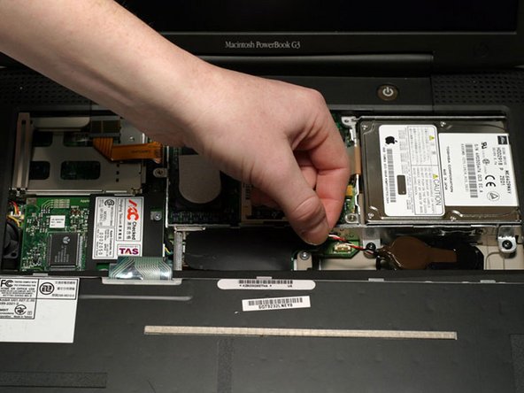

    2. PowerBook G3 Lombard PRAM Battery Replacement: step 5, image 1 of 1
      • Remove the battery from its holder by pulling up and to the left.
