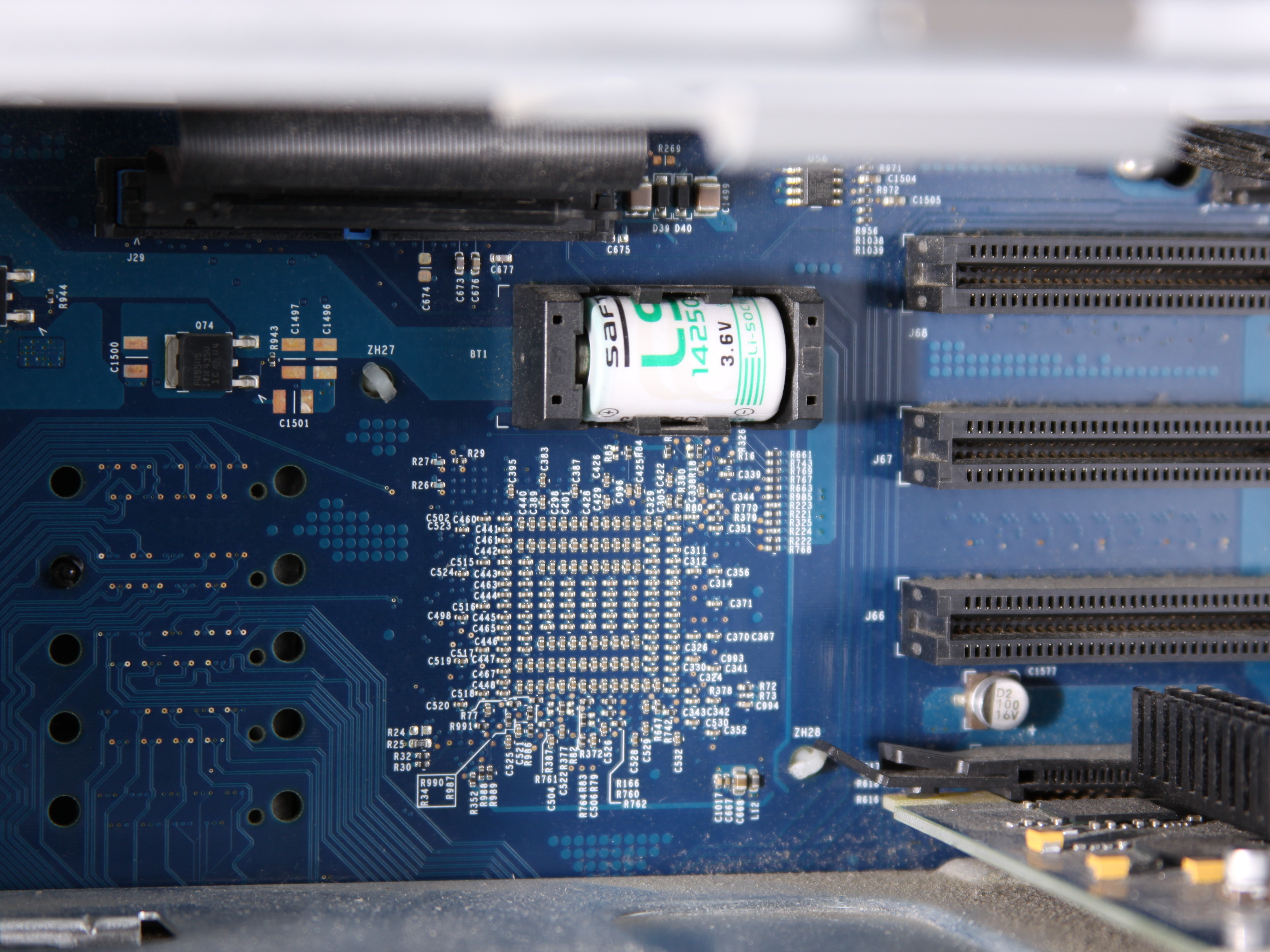

    1. Power Mac G5 PRAM Battery Replacement, PRAM Battery: step 5, image 1 of 1
      • Locate the battery inside the desktop.
      Ask FixBot
    2. Power Mac G5 PRAM Battery Replacement: step 6, image 1 of 3 Power Mac G5 PRAM Battery Replacement: step 6, image 2 of 3 Power Mac G5 PRAM Battery Replacement: step 6, image 3 of 3
      • Remove the battery by lifting the battery from the battery terminal.
      • Be careful to note which end is positive and which is negative. The positive end should be facing away from the PCI slots.
      • It is important to lift the battery as straight up as possible to avoid damage to battery or terminal.
      • The first photo shows the correct battery position. The last two photos show the battery facing the WRONG WAY! Remember, the positive end should be facing AWAY from the PCI slots, NOT towards them.

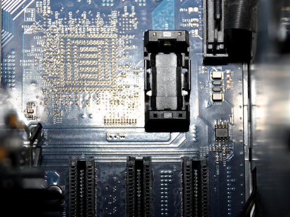

    3. Power Mac G5 PRAM Battery Replacement: step 7, image 1 of 1
      • The area should look like this after the battery is removed.
      • Be sure to properly dispose of the old battery after removal (take it to the nearest hazardous waste center).
      • Only insert LS1425OC 3.6V battery to prevent damage to the logic board.

plz advise the type of battery, thx !
adrianchan - Reply Share
Thank you, very very instructive - but why on Earth
does Apple not mark the battry holder on this model
with + and - ? ? Now, thanks to your close-up photo
I found out which way to turn the battery. (I hope)
Best regards
Torben, Denmark
Torben Hellborn - Reply Share
Agreed - slot should be marked with + and – . . .
Thanks for the clear and sharp photos d;-)
Andrew Lawes - Reply Share
This is not valid for the late 2005 model of G5…Model 11,2.
It uses a coin shaped Panasonic Lithium battery. I just ordered one from OWC.
($.88)
Sari - Reply Share
