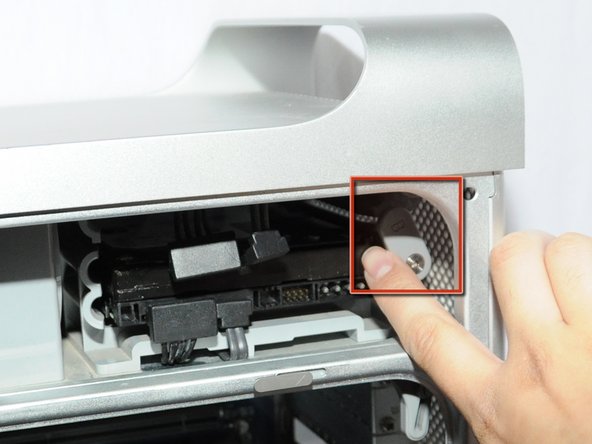

    2. Power Mac G5 Hard Drive Replacement: step 6, image 1 of 2 Power Mac G5 Hard Drive Replacement: step 6, image 2 of 2
      • Rotate up plastic tab labeled "B" on the right hand side of hard drive.
      Ask FixBot

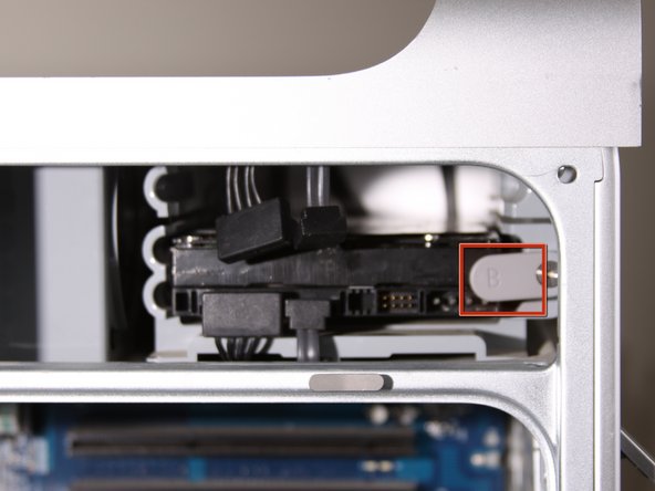

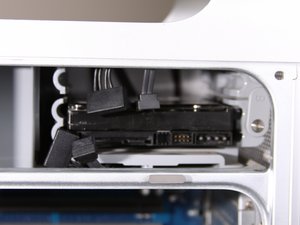

    3. Power Mac G5 Hard Drive Replacement: step 7, image 1 of 2 Power Mac G5 Hard Drive Replacement: step 7, image 2 of 2
      • Detach both cables from the hard drive.
      Ask FixBot

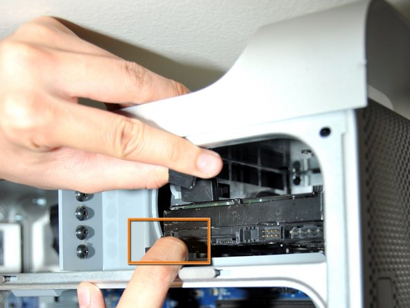

    4. Power Mac G5 Hard Drive Replacement: step 8, image 1 of 2 Power Mac G5 Hard Drive Replacement: step 8, image 2 of 2
      • Pull out the hard drive out.
      Ask FixBot

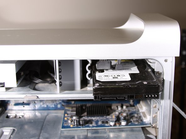

    5. Power Mac G5 Hard Drive Replacement: step 9, image 1 of 1
      • After hard drive is out, the space should look like this.
      Ask FixBot
