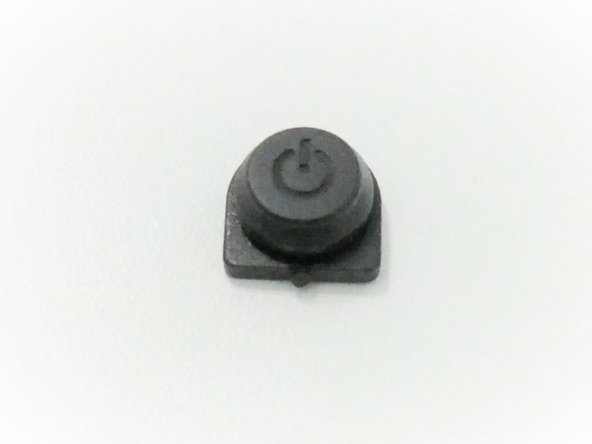

    4. Power Button Replacement: step 4, image 1 of 3 Power Button Replacement: step 4, image 2 of 3 Power Button Replacement: step 4, image 3 of 3
      • With aid of a pointy tool, push the damaged flexible button from the top down.
      • Using the fingers, insert the new flexible button from the top-down into the case opening. Make sure the button flange is not folded.
