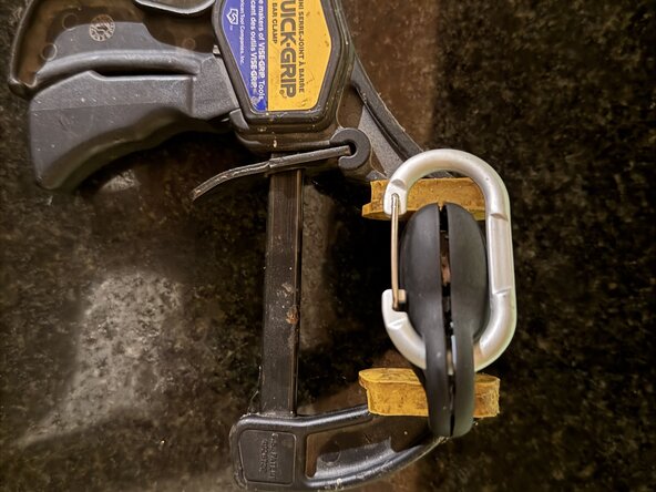

    1. Power Bank - Resolder USB Ports, Take Apart Power Bank: step 1, image 1 of 3 Power Bank - Resolder USB Ports, Take Apart Power Bank: step 1, image 2 of 3 Power Bank - Resolder USB Ports, Take Apart Power Bank: step 1, image 3 of 3
      • Gently squeeze the power bank with a quick grip/clamp as shown.
      • The power bank should separate under gentle force from the grip/clamp.
      • Continue to separate with your fingers or plastic pry tools.

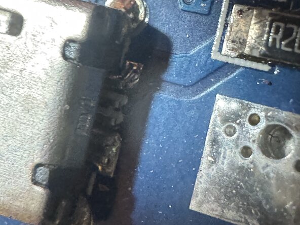

    2. Power Bank - Resolder USB Ports, Inspect Back Sides of Power Bank USB-A Port: step 2, image 1 of 3 Power Bank - Resolder USB Ports, Inspect Back Sides of Power Bank USB-A Port: step 2, image 2 of 3 Power Bank - Resolder USB Ports, Inspect Back Sides of Power Bank USB-A Port: step 2, image 3 of 3
      • Use a 10x loupe to inspect the back side of each USB port.
      • If the pins are not in contact with the pads, they will need to be resoldered.
      Ask FixBot
      • Apply heat to the top metal of the micro-USB port.
      • Squeeze USB port to PCB with a pair of pliers.
      • Apply fresh solder to USB pin and PCB pad.
      • Solder should wick in, allow to cool before reassembling.
      • Use a small amount of plastic compatible epoxy to seal both halves back together.
