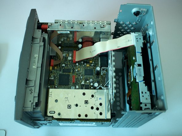

  4. Porsche 997.1 PCM 2.1 Screen Replacement, Separating the CD unit from the main chassis: step 4, image 1 of 1
    • Use a plastic spudger to disconnect the PC ribbon cable joining the CD player to the motherboard and place the CD unit safely to one side.

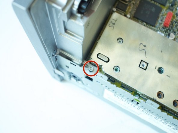

  5. Porsche 997.1 PCM 2.1 Screen Replacement, Removing the torx fasteners connecting the facia with the main chassis: step 5, image 1 of 2 Porsche 997.1 PCM 2.1 Screen Replacement, Removing the torx fasteners connecting the facia with the main chassis: step 5, image 2 of 2
    • Remove the two Torx T9 machine screws that attach the front facia to the chassis. There is one screw either side as shown in the photos.

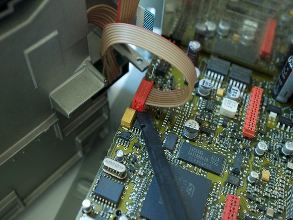

  6. Porsche 997.1 PCM 2.1 Screen Replacement, Disconnecting the ribbon cable: step 6, image 1 of 2 Porsche 997.1 PCM 2.1 Screen Replacement, Disconnecting the ribbon cable: step 6, image 2 of 2
    • Open the ribbon cable lock (there is probably a proper name for it) and remove the ribbon cable on the left hand side of the unit.

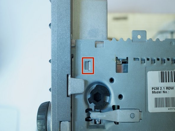

  7. Porsche 997.1 PCM 2.1 Screen Replacement, Identifying the tab retainers keeping the facia connected to the chassis: step 7, image 1 of 3 Porsche 997.1 PCM 2.1 Screen Replacement, Identifying the tab retainers keeping the facia connected to the chassis: step 7, image 2 of 3 Porsche 997.1 PCM 2.1 Screen Replacement, Identifying the tab retainers keeping the facia connected to the chassis: step 7, image 3 of 3
    • This is the most difficult step in the process. Firstly, identify the four tab retainers holding the facia to the chassis. The three photos show them all.

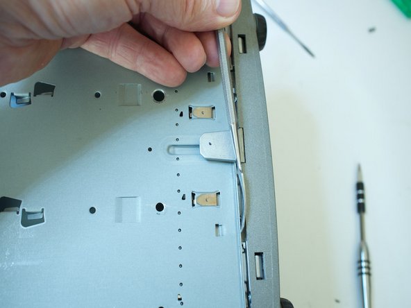

  8. Porsche 997.1 PCM 2.1 Screen Replacement, Using a metal spludger to disconnect the retaining tabs: step 8, image 1 of 2 Porsche 997.1 PCM 2.1 Screen Replacement, Using a metal spludger to disconnect the retaining tabs: step 8, image 2 of 2
    • A curved metal spudger seemed to work well for this. Each tab had to be carefully leveraged up to disconnect them from the facia.

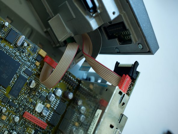

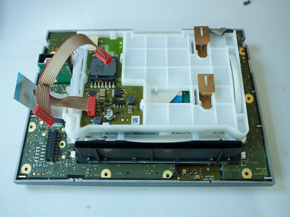

  10. Porsche 997.1 PCM 2.1 Screen Replacement, Disconnect the PC ribbon cables joining the facia to the chassis: step 10, image 1 of 2 Porsche 997.1 PCM 2.1 Screen Replacement, Disconnect the PC ribbon cables joining the facia to the chassis: step 10, image 2 of 2
    • Use a spudger to disconnect the PC ribbon cables connecting the facia to the chassis.

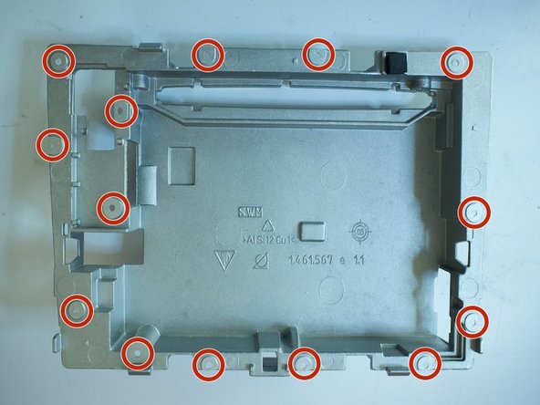

  11. Porsche 997.1 PCM 2.1 Screen Replacement, Identify all the torx T9 fasteners on the facia: step 11, image 1 of 2 Porsche 997.1 PCM 2.1 Screen Replacement, Identify all the torx T9 fasteners on the facia: step 11, image 2 of 2
    • The two halves of the facia are connected using 14 torx T9 self tapping screws.
    • If you only find thirteen, you have missed one of the little blighters. If you only find twelve.. well see previous comment but add one to the list of missed fasteners. The back of the casting is show as it better indicate the fastener placements.

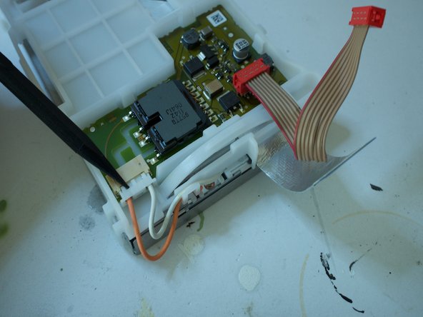

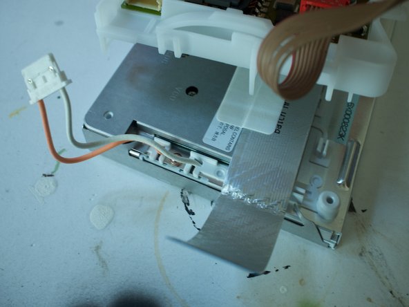

  14. Porsche 997.1 PCM 2.1 Screen Replacement, Separating the screen from the screen carrier: step 14, image 1 of 3 Porsche 997.1 PCM 2.1 Screen Replacement, Separating the screen from the screen carrier: step 14, image 2 of 3 Porsche 997.1 PCM 2.1 Screen Replacement, Separating the screen from the screen carrier: step 14, image 3 of 3
    • Use a spudger to disconnect the orange/white cable. This only reconnects one way. Unhook the orange/white cable from the screen carrier and the carrier will lift away from the screen.

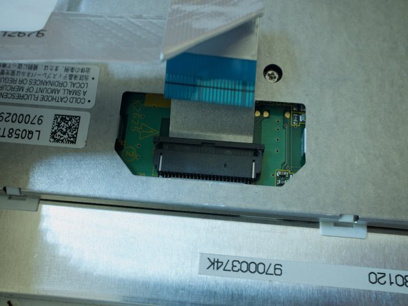

  15. Porsche 997.1 PCM 2.1 Screen Replacement, Disconnect the screen ribbon cable: step 15, image 1 of 1
    • Disconnect the ribbon cable using the same technique that was done at the other end, where it connects to the motherboard.
  16. Porsche 997.1 PCM 2.1 Screen Replacement, Transfer the ribbon cable: step 16, image 1 of 1
    • Transfer the ribbon cable to the new screen.
