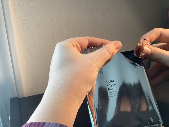

  3. Polaroid Now i-Type Film Pack Replacement, Insert New i-Type Film Pack: step 3, image 1 of 2 Polaroid Now i-Type Film Pack Replacement, Insert New i-Type Film Pack: step 3, image 2 of 2
    • The film pack comes in a silver-plastic wrapping, take this off by ripping it and throw away/recycle it.
    • Now, insert the film into the camera with the dark slide up and the rainbow tab facing towards you. Make sure to not squish the film as this may expose/ beak the chemical packet in the film.
    • Push pack in firmly until you hear a click.
