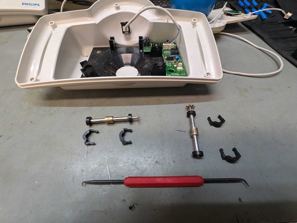

    1. Philips Roller Controller Repair, Philips Roller Controller Repair: step 1, image 1 of 1
      • Remove the 5 screws on the bottom edge.

    2. Philips Roller Controller Repair: step 2, image 1 of 1
      • Detach the top cover.
      • Watch out for the connector for the buttons on the right side. Disconnect it.
      Ask FixBot
    3. Philips Roller Controller Repair: step 3, image 1 of 1
      • Disconnect the two connectors. Note their position for reassembly.
      Ask FixBot
    4. Philips Roller Controller Repair: step 4, image 1 of 3 Philips Roller Controller Repair: step 4, image 2 of 3 Philips Roller Controller Repair: step 4, image 3 of 3
      • You can pull the tabs on both sides slightly outward and then carefully pull the clip upward.
      • Use a pick to carefully release the bearing retainer.
      Ask FixBot
    5. Philips Roller Controller Repair: step 5, image 1 of 1
      • Remove the two screws and you can take out the PCB.
      Ask FixBot

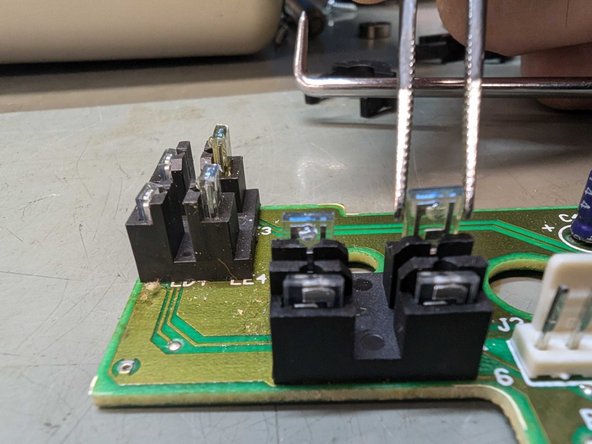

    6. Philips Roller Controller Repair: step 6, image 1 of 1
      • Replacement parts you need:
      • 4x LTR-301 Infrared Receiver
      • 4x LTE-302 Infrared Emitter
      • The emitters, LTE-302, are mounted on the inside and replace the BLUE-tinted emitters.
      • The receivers are positioned against the outer edge of the board. These are the LTR-301 types.
      • Often only the emitters are faulty, but we prefer to replace both the emitters and the receivers.
      Ask FixBot
    7. Philips Roller Controller Repair: step 7, image 1 of 2 Philips Roller Controller Repair: step 7, image 2 of 2
      • Desolder the emitters.
      • Place the replacement parts and solder them back into place with a little flux.
      • Ensure that you place the parts neatly into the holder and that both the receiver and the transmitter are at the same height.
      Ask FixBot
      • You can reassemble the controller in reverse order.
