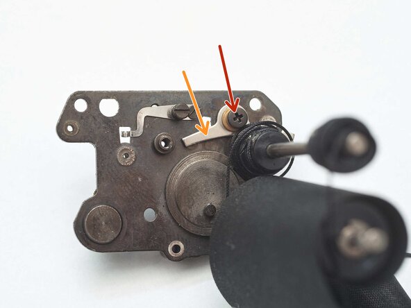

    5. Pentax MX Shutter Curtains Disassembly, Remove shutter release arm: step 24, image 1 of 1
      • Mark the vertical position of the shutter release arm on the release shaft.
      • Remove two M1.4 x 2.4 mm screws.
      • Remove shutter release arm.
      Ask FixBot
    6. Pentax MX Shutter Curtains Disassembly, Remove shutter release shaft: step 25, image 1 of 2 Pentax MX Shutter Curtains Disassembly, Remove shutter release shaft: step 25, image 2 of 2
      • Remove one M1.4 x 2.4 mm screw.
      • Remove the shutter release plate.
      • Slide the shutter release shaft out from the bottom of the camera.
      • Keep track of the coil spring as it slides off.
      Ask FixBot
    7. Pentax MX Shutter Curtains Disassembly, Remove closing curtain latch: step 26, image 1 of 2 Pentax MX Shutter Curtains Disassembly, Remove closing curtain latch: step 26, image 2 of 2
      • Remove one M1.4 slotted nut.
      • Push the latch out from between the wind gears and slide it off the shaft.
      • Installation Notes: Note the position of the bias springs during installation.

    2. Pentax MX Shutter Curtains Disassembly, Remove opening curtain latch: step 54, image 1 of 1
      • Remove one screw.
      • Remove opening curtain latch.
