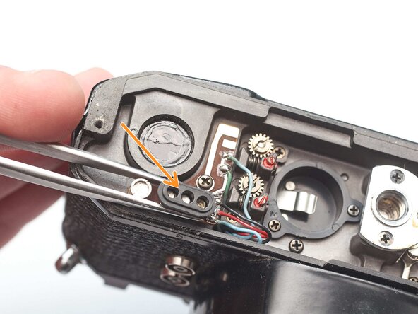

    1. Pentax MX Mirror Box Removal, Remove bottom cover: step 8, image 1 of 2 Pentax MX Mirror Box Removal, Remove bottom cover: step 8, image 2 of 2
      • Remove three M1.7 x 2.0 mm countersunk screws.
      • Lift off bottom cover.
      • Remove loose plastic housing for motor drive contacts.
