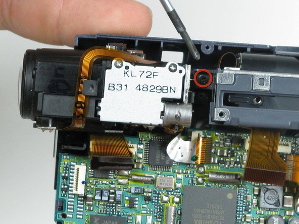

    1. Panasonic PV-GS9 Lens Replacement, Lens: step 13, image 1 of 2 Panasonic PV-GS9 Lens Replacement, Lens: step 13, image 2 of 2
      • Using #00 phillips screwdriver, remove two 4.5mm black screws holding lens in place.
      Ask FixBot
    2. Panasonic PV-GS9 Lens Replacement: step 14, image 1 of 1
      • Remove third 4.5mm lens mount screw near front of camera.
      Ask FixBot
    3. Panasonic PV-GS9 Lens Replacement: step 15, image 1 of 3 Panasonic PV-GS9 Lens Replacement: step 15, image 2 of 3 Panasonic PV-GS9 Lens Replacement: step 15, image 3 of 3
      • Careful that both lens ribbon cables are removed from logic board, remove lens.
