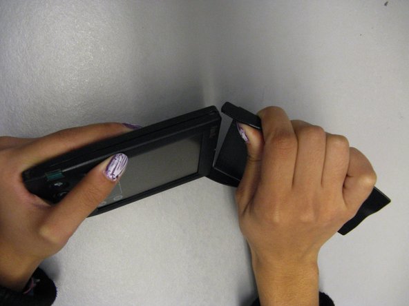

      • Gently pull off plastic device cover where it connects to the rest of the Palm IIIc.
      • Keep track of the device cover.

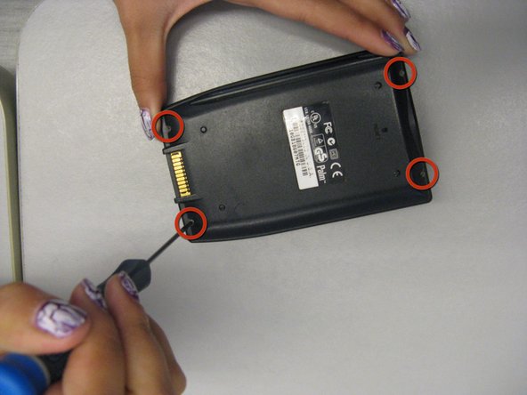

      • Using a Phillips head screw driver, take out the four screws on the back of the device. You may have to pull them out with your hands once they are unscrewed.
      • Keep track of your four screws. Don't lose them.

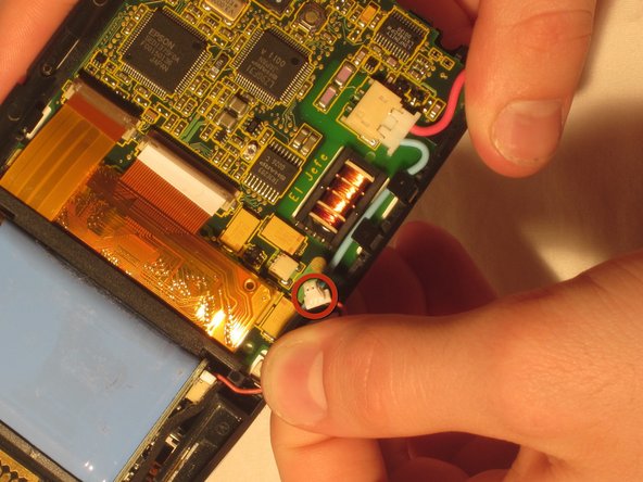

      • Unhook the battery cable from the motherboard and remove the battery.

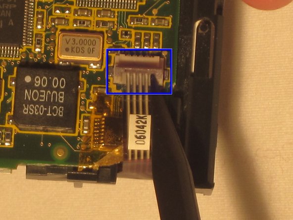

      • Use tweezers to pull up the ZIF connector (the brown plastic tab) on the back of the motherboard and disconnect the tail, which looks like a ribbon.
      • Once the ZIF connector is unattached, remove the clear screen cover using a spudger. Some force may be necessary.

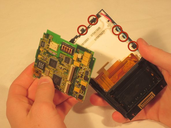

    8. Palm IIIc LCD Screen Replacement: step 8, image 1 of 1
      • Gently pull the black clips on the inside case to detach the motherboard from the device. Pull the motherboard out towards the bottom left corner.
