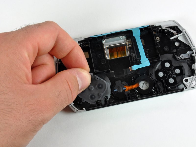

    1. PSP Go Gamepad Buttons Replacement, Gamepad Buttons: step 17, image 1 of 1
      • Lift the gamepad buttons out of the PSP Go.
