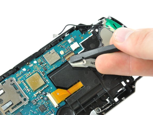

    2. PSP 300xc Motherboard Replacement: step 25, image 1 of 1
      • Using the flat edge of a spudger, pry the wireless board cable connector straight up and off the motherboard.
      Ask FixBot

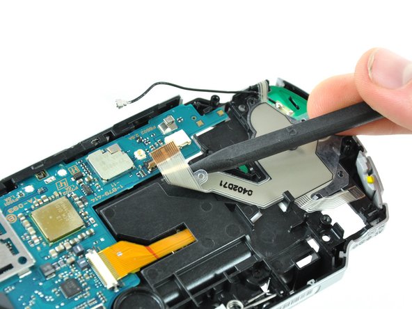

    3. PSP 300xc Motherboard Replacement: step 26, image 1 of 3 PSP 300xc Motherboard Replacement: step 26, image 2 of 3 PSP 300xc Motherboard Replacement: step 26, image 3 of 3
      • Using a fingernail or spudger, flip up the retaining flap on the following three ZIF connectors.
      • Action button contact pad ribbon
      • UMD drive ribbon
      • Be sure you are prying up on the retaining flap, not the socket itself.
      • Use your fingernail or tip of a spudger to push both sides of the black retaining flap on the UMD laser ribbon socket to the right.
      • Use your fingers or a spudger to gently pull all three ribbon cables straight out of their sockets.

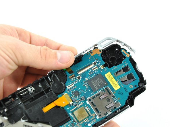

    5. PSP 300xc Motherboard Replacement: step 28, image 1 of 2 PSP 300xc Motherboard Replacement: step 28, image 2 of 2
      • Lift the motherboard up from its bottom edge about 45 degrees from the case.
      • Slowly attempt to pull the motherboard out at roughly a 45 degree angle from the case.
      • It takes a little fidgeting to get the motherboard to come apart from the case.
