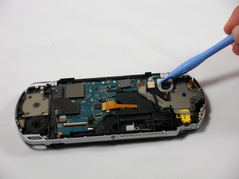

    1. PSP 2000 Speaker Replacement, Speaker: step 8, image 1 of 2 PSP 2000 Speaker Replacement, Speaker: step 8, image 2 of 2
      • Use the opening tools to press the tab on the left-hand side of the speaker to release it.
      • Be careful not to puncture the speaker in the process.
      • Remove the speaker by twisting it counter-clockwise (to the left, like a screw).
