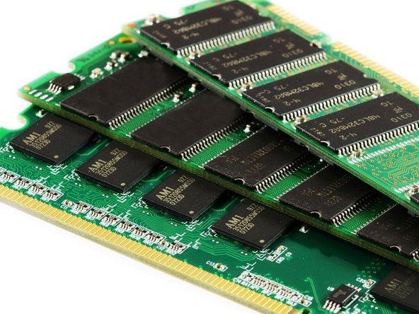

    2. PC tower teardown, RAM stick: step 2, image 1 of 1
      • Next, we begin removing all the parts from the motherboard; first, the RAM sticks—in my case, I have 4 DDR slots with 2 GB capacity each.

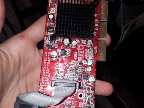

    4. PC tower teardown, Graphics card: step 4, image 1 of 1
      • We will also need to remove the graphics card, which connects to the PCI-Express x16 expansion slot and also has a serial port and a VGA port on the back.

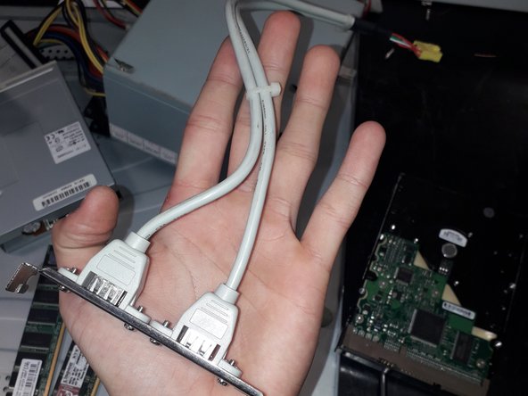

    10. PC tower teardown, X2 USBs: step 10, image 1 of 1
      • We also need to remove two USB devices that are connected to the motherboard and go to the rear panel.

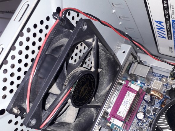

    11. PC tower teardown, Cooling fan: step 11, image 1 of 1
      • Finally, we need to remove the power supply's cooling fan. Also, keep in mind that when reassembling, you should keep the cooling fan screws separate from other components, as they are different and not all of them are interchangeable.
