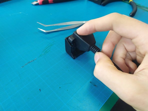

    1. PC build for Restart PCs, Cleaning the parts: step 1, image 1 of 3 PC build for Restart PCs, Cleaning the parts: step 1, image 2 of 3 PC build for Restart PCs, Cleaning the parts: step 1, image 3 of 3
      • Remove the stringing by hand.
      • Remove the two "tabs" at the base of the block using the utility knife.
      • Remove the supports with flush cutters and the utility knife.
      • Be careful not to cut yourself.

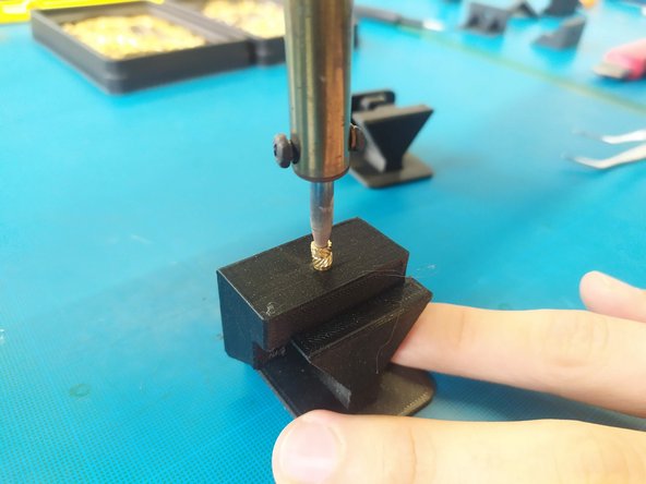

    2. PC build for Restart PCs, Adding the insert: step 2, image 1 of 3 PC build for Restart PCs, Adding the insert: step 2, image 2 of 3 PC build for Restart PCs, Adding the insert: step 2, image 3 of 3
      • Install the block onto the support.
      • The support makes it easier to install the block in a better position and increases the stability of the part during the operation.
      • Add the threaded inserts (see following steps for sizes).
      • Use a small flat file or any other flat tool to finish pressing the inserts in.
      • If there is plastic on the iron, please clean it with the sponge.

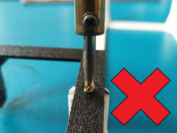

    3. PC build for Restart PCs, Insert tip: step 3, image 1 of 2 PC build for Restart PCs, Insert tip: step 3, image 2 of 2
      • Pay attention to the orientation.
      Ask FixBot
    4. PC build for Restart PCs, Insert tip (continued): step 4, image 1 of 3 PC build for Restart PCs, Insert tip (continued): step 4, image 2 of 3 PC build for Restart PCs, Insert tip (continued): step 4, image 3 of 3
      • The inserts must not protrude.
      • The surface in contact with the sheet metal must be as flat as possible.
      • If necessary, clean off any plastic burrs on the underside with a utility knife.
