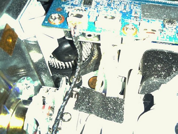

    8. Optoma H180X Projector Disassembly, Close up: internal fan: step 8, image 1 of 1
      • If you have the "fan fail" problem, then this fan (which can be seen from above/front) is the one that you will need to clean.
      • I cleaned this with compressed air (using a small compressor unit). This might NOT be the optimal way to clean it, but it did work. :)
      • You might be able to clean it manually by removing the top circuit board - however, cleaning it with compressed air means that you do not need to remove any further parts.

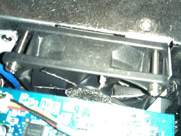

    9. Optoma H180X Projector Disassembly, Close up: other fan (beside lamp): step 9, image 1 of 1
      • This is the second fan that might need to be cleaned as well. You can clean this fan by just removing the lamp - and not having to remove the top plastic from the projector.
