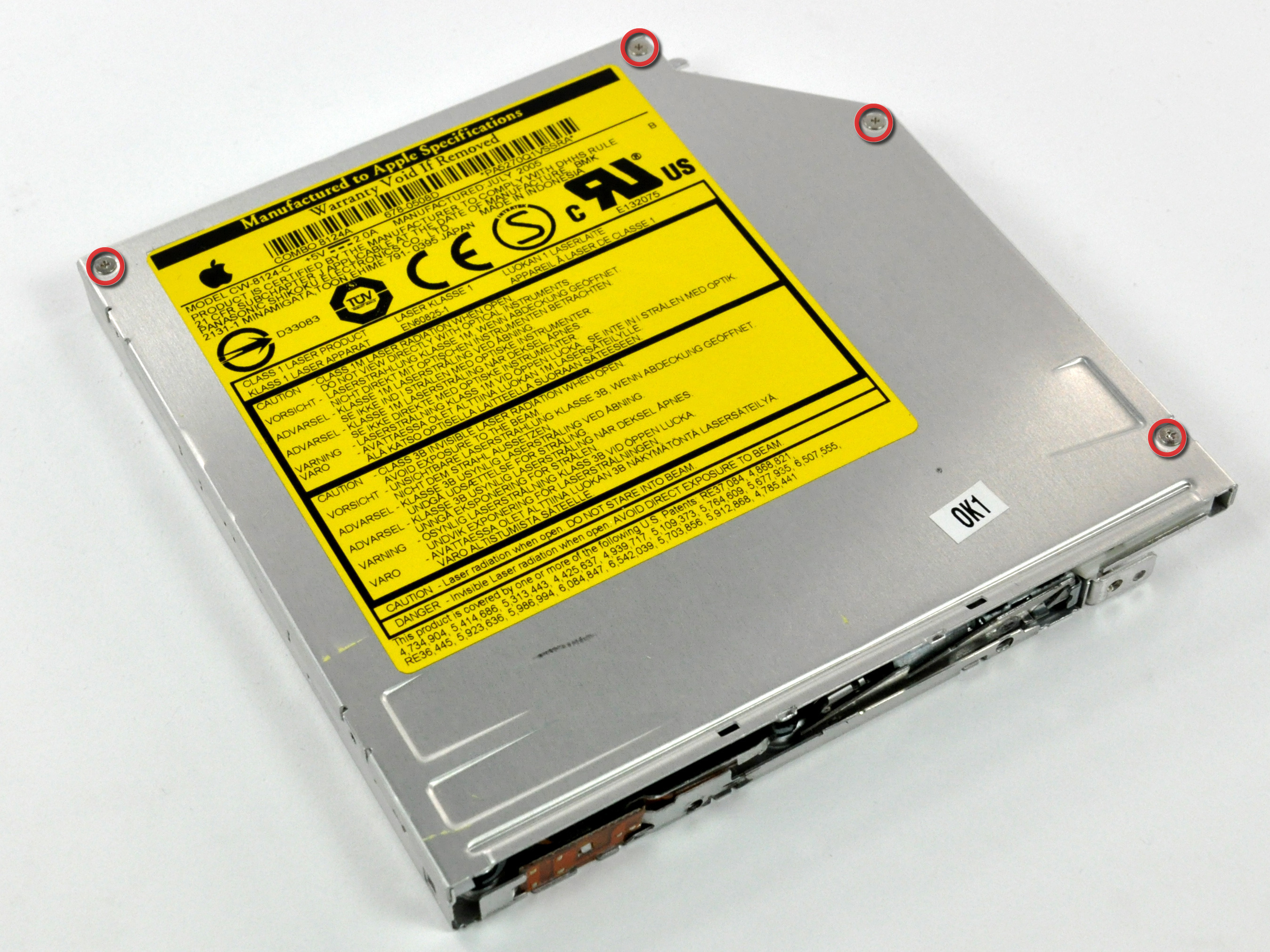

Did your optical drive devour your favorite CD? Did your 3-year-old fill the slot with coins? Worry no more! This guide will show you how to remove a jammed disk or foreign object from your optical drive.
With the optical drive removed from the computer, remove the screws securing the top panel of the optical drive.

There should be a caveat. The screws are extremely tiny and can strip easily, besides get lost. Be sure to work away from the edge of a table. On my MBP early 2008 17" there are three brackets, it's a good idea to snap a photo of the layout or mark with a pen to help re-orient.
Also though my case looked like the one above, the label was reversed and the drive was a Panasonic made in China. On trying to open the case per the instructions it should be noted there's a circuit board looking piece of plastic with the ribbon cable, remove first by prying away.
Also when I got the left side unhinged, the right side would not slide so it took twisting the top clockwise, the right side stayed attached though I got the case cracked about 45 degrees and got my system install disk out. On reassembly be very careful to line up the top holes to the metal underneath, and check first around the case edge that it is completely seated. Don't over tighten the screws or they will strip.
Never the less on the rear bracket that fastens to the logic board hole the screws wouldn't take and the bracket stayed loose. Am considering a dab of epoxy in the holes wiped flush to re-attach the bracket after drying.
Hi Andrew, I managed to do this stage to remove a stuck disc after all the Apple suggestions failed and found it straight forward and interesting. However after reinstalling everything back in place and powering up I found everything working as before with the exception of the WiFi/Bluetooth and possibly the camera,although I haven't tested that yet. Due to enlarging the screen on my IPad to view stage 5 in greater detail, the written word on the right Was off screen so I missed the part regarding the small clear plastic cable retainer and also the part about aligning the connector . Is it possible this could have a bearing on my lack of wifi and Bluetooth? I notice in some other comments that people have broken this small clear plastic retainer and although I didn't see anything laying on the logic board would that last be relevant to the missing hardware? Regards Peter
