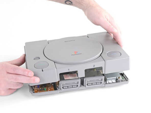

      • Turn the console upside down and remove the five 15.8 mm-long Phillips #1 screws.
      Ask FixBot
    2. Opening Procedure: step 2, image 1 of 2 Opening Procedure: step 2, image 2 of 2
      • Flip the console back over (making sure to hold the top and bottom halves together) and lift up on the top cover to remove it.
