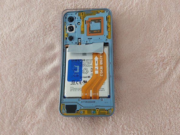

    1. Open the phone, The phone: step 1, image 1 of 3 Open the phone, The phone: step 1, image 2 of 3 Open the phone, The phone: step 1, image 3 of 3
      • To pry open the phone cover you will need a small suction cup and a plastic opening tool.
      • Do not use heat like with older phones because everything will melt.
      • It is recommended to replace the cover with a new one, or if it is for a customer, in case they want to change the color.
