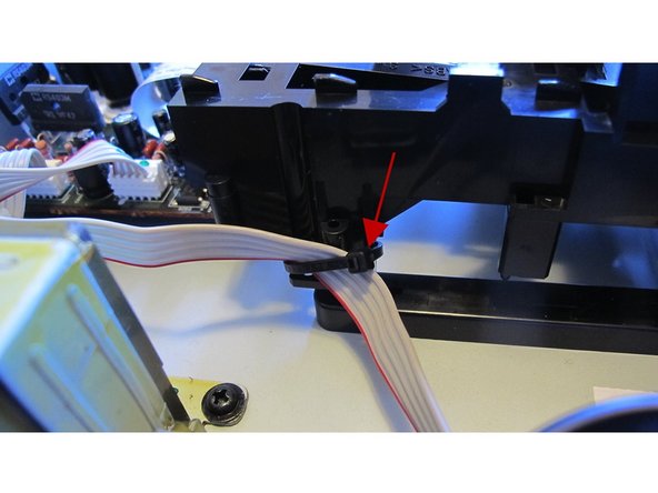

    • Now, turn the unit back on its feet. Looking from the front of the player, there is a ribbon cable held to the side of the housing with a cable tie (see red arrow). This should be cut off with scissors. Replacement of this tie is not needed on reassembly (center photo).
