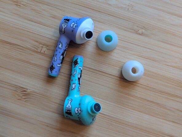

    2. OnePlus Buds Z replacement battery replacement, Removing the rubber tips: step 2, image 1 of 1
      • Remove the rubber tips by pulling them off.

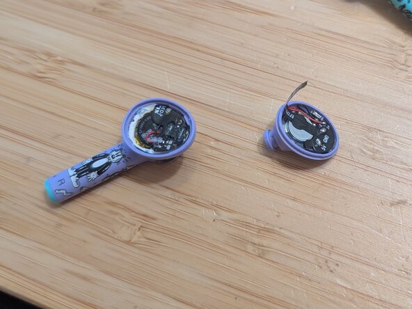

    3. OnePlus Buds Z replacement battery replacement, Opening the housing: step 3, image 1 of 3 OnePlus Buds Z replacement battery replacement, Opening the housing: step 3, image 2 of 3 OnePlus Buds Z replacement battery replacement, Opening the housing: step 3, image 3 of 3
      • Heat the bud with a hairdryer, a heat gun, or a hot/cold pack.
      • Hold the bud as shown so that the earpiece is pointing diagonally toward you.
      • Carefully apply pressure to the earpiece so that a small gap opens.
      • You should only feel a little resistance. If you feel a lot of resistance, continue heating the bud until the gap opens without any issues.

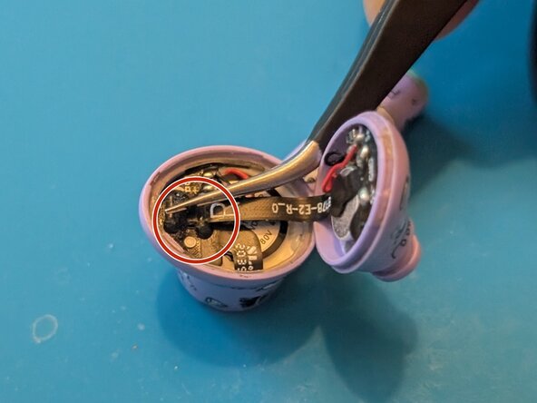

    4. OnePlus Buds Z replacement battery replacement, Removing adhesive residue: step 4, image 1 of 1
      • Use tweezers to remove the adhesive residue that held the housing together. If necessary, apply more heat to assist with this.
      • Be meticulously careful not to damage the ribbon cable. It is very sensitive to shear forces. Unfortunately, this ended up being my downfall during the process.

    10. OnePlus Buds Z replacement battery replacement, Closing the housing: step 10, image 1 of 1
      • You can now carefully fold the ribbon cable back and snap the housing together.
      • If you like, you can use a suitable liquid adhesive to close the housing even more securely. Actually, it holds quite well without it, too. However, I would advise against using double-sided tape for the housing. I tore the ribbon cable right through when I tried to apply it.

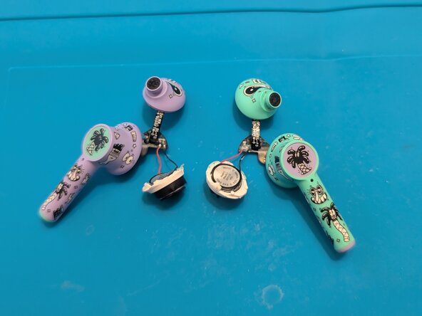

    11. OnePlus Buds Z replacement battery replacement, The worst case has happened: The ribbon cable is torn - what now?: step 11, image 1 of 3 OnePlus Buds Z replacement battery replacement, The worst case has happened: The ribbon cable is torn - what now?: step 11, image 2 of 3 OnePlus Buds Z replacement battery replacement, The worst case has happened: The ribbon cable is torn - what now?: step 11, image 3 of 3
      Tool used on this step:
      Technician's Razor Set
      $14.99
      Buy
      • First of all, the biggest problem: The only available spare parts come from defective buds. You'll therefore have to find some on eBay. Unfortunately, the earpiece itself isn't even available on AliExpress. However, if you have found a spare part, it's not that difficult to fix the earbud.
      • Remove the adhesive strip on the ribbon cable connector.
      • Now remove the UV glue, either using tweezers and a hot air station or – like me – by carefully scraping it off with a scalpel.
      • Now separate the earpiece from the PCB with the help of a spudger.
      • Secure the connection with UV glue or hot glue.
      • Jump back to step 10 and enjoy your great headphones, which will now last for a long train ride again.
