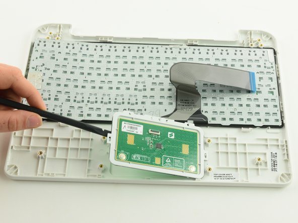

    1. One Education Infinity One Touchpad Replacement, Touchpad: step 11, image 1 of 2 One Education Infinity One Touchpad Replacement, Touchpad: step 11, image 2 of 2
      • Use a spudger to pry the touchpad away from the device.
      Ask FixBot
