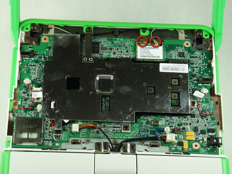

    1. OLPC XO-4 Touch Wireless Card Replacement, Wireless Card: step 14, image 1 of 3 OLPC XO-4 Touch Wireless Card Replacement, Wireless Card: step 14, image 2 of 3 OLPC XO-4 Touch Wireless Card Replacement, Wireless Card: step 14, image 3 of 3
      • When pulling out the connectors, make sure to hold the metal connector instead of the wire.
      • Gently pull out the two antenna connectors by pulling them away from the motherboard.
      Ask FixBot
    2. OLPC XO-4 Touch Wireless Card Replacement: step 15, image 1 of 1
      • Remove the black 4mm Phillips #1 screw holding the wireless card in.
      Ask FixBot
    3. OLPC XO-4 Touch Wireless Card Replacement: step 16, image 1 of 2 OLPC XO-4 Touch Wireless Card Replacement: step 16, image 2 of 2
      • Remove the wireless card from the laptop by gently sliding it out of its socket.
