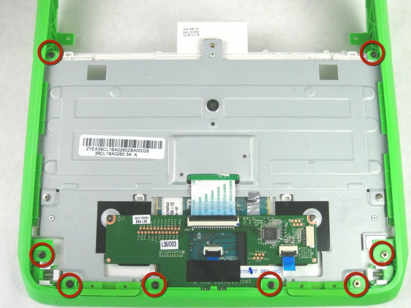

    1. OLPC XO-4 Touch Mouse Buttons Controller Replacement, Mouse Buttons Controller: step 16, image 1 of 3 OLPC XO-4 Touch Mouse Buttons Controller Replacement, Mouse Buttons Controller: step 16, image 2 of 3 OLPC XO-4 Touch Mouse Buttons Controller Replacement, Mouse Buttons Controller: step 16, image 3 of 3
      • You should now be looking at the bottom of the lower case.
      • Remove the eight 4mm Phillips #1 screws attaching the green trim pieces to the lower frame.
      • Pry off the front and side trim pieces.
      Ask FixBot
    2. OLPC XO-4 Touch Mouse Buttons Controller Replacement: step 17, image 1 of 1
      • Remove the two 4mm Phillips #1 screws that attach the mouse buttons controller to the lower frame.
      Ask FixBot
