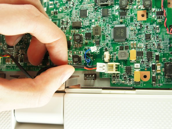

    2. OLPC XO-1.5 Power Button Replacement: step 18, image 1 of 1
      • Rotate the device 180° and open the lid.
      • Disconnect the microphone cable by pulling its connector straight out of its socket on the motherboard.
      Ask FixBot

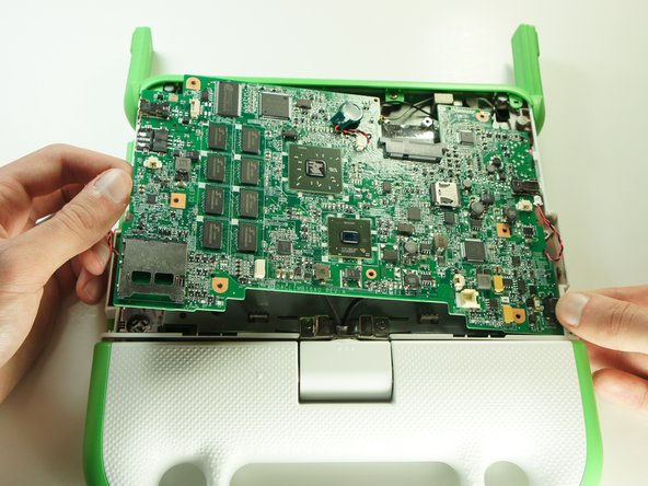

    3. OLPC XO-1.5 Power Button Replacement: step 19, image 1 of 3 OLPC XO-1.5 Power Button Replacement: step 19, image 2 of 3 OLPC XO-1.5 Power Button Replacement: step 19, image 3 of 3
      • Close the lid and rotate the device 180°.
      • Lift the left edge of the motherboard and remove it from the case.
      • Make sure that the microphone and headphone jack don't catch on the case as you are removing the motherboard.
      Ask FixBot

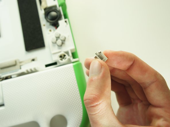

    1. OLPC XO-1.5 Power Button Replacement, Power Button: step 20, image 1 of 3 OLPC XO-1.5 Power Button Replacement, Power Button: step 20, image 2 of 3 OLPC XO-1.5 Power Button Replacement, Power Button: step 20, image 3 of 3
      • Push the four power button retaining clips through the bottom of the case with the tip of a screwdriver.
      • Open the lid, rotate it 180° degrees, and close it again.
      • Be careful not to lose the small spring that sits inside the power button.
