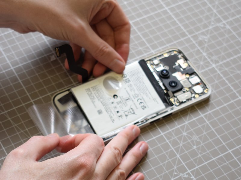

    18. Nothing Phone (2a) Battery Replacement, Pull all stickers surrounding the battery, in order: step 18, image 1 of 3 Nothing Phone (2a) Battery Replacement, Pull all stickers surrounding the battery, in order: step 18, image 2 of 3 Nothing Phone (2a) Battery Replacement, Pull all stickers surrounding the battery, in order: step 18, image 3 of 3
      • Now, ensure that the large flex cable that we have just removed is out of the way.
      • We will now focus on removing the battery.
      • To do this, pull all the stickers off that keep the battery in.Nothing has kindly labelled these, 1, 2, 3.
      • Remove the sticker up the right side first, then the small tabs up the left, then the big tab on the left.
      • Fold them outwards to make space for you to pull the 3rd sticker back from top to bottom.
      Ask FixBot
    19. Nothing Phone (2a) Battery Replacement, Lift the battery out left side first: step 19, image 1 of 3 Nothing Phone (2a) Battery Replacement, Lift the battery out left side first: step 19, image 2 of 3 Nothing Phone (2a) Battery Replacement, Lift the battery out left side first: step 19, image 3 of 3
      • Once all the stickers have been peeled back, make sure they are out of the way, folded away from the battery.
      • Pull the big tab (number 2) and pull the battery out left edge first.
      Ask FixBot
