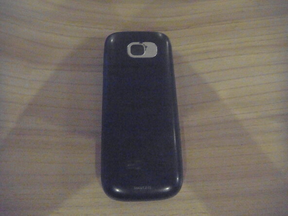

I apologize for the grainy photos, I don't have a very good camera.
    1. Nokia C2-01 Dissasembly, Nokia C2-01: step 1, image 1 of 3 Nokia C2-01 Dissasembly, Nokia C2-01: step 1, image 2 of 3 Nokia C2-01 Dissasembly, Nokia C2-01: step 1, image 3 of 3
      • Remove back cover by sliding downwards.
      • Remove battery and sim card (if applicable).

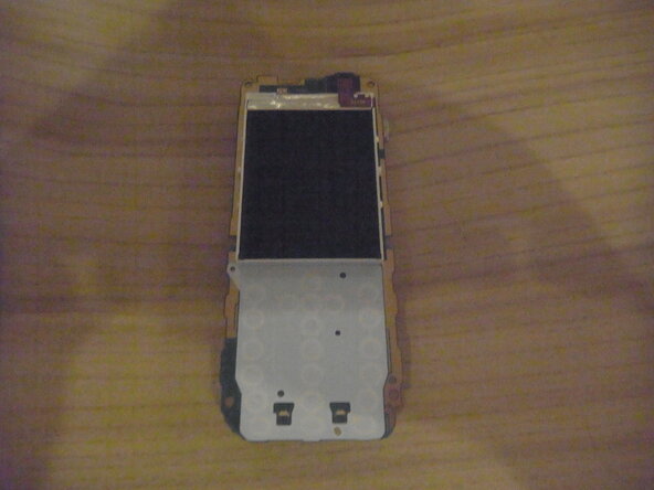

    4. Nokia C2-01 Dissasembly: step 4, image 1 of 2 Nokia C2-01 Dissasembly: step 4, image 2 of 2
      • Remove four 5mm-long screws in the corners of the motherboard using a Torx T6 screwdriver.
      • Be careful not to touch the LCD screen!
      Ask FixBot
    5. Nokia C2-01 Dissasembly, Seperate the motherboard: step 5, image 1 of 3 Nokia C2-01 Dissasembly, Seperate the motherboard: step 5, image 2 of 3 Nokia C2-01 Dissasembly, Seperate the motherboard: step 5, image 3 of 3
      • Pull one plastic clip out of the way and gently lift and pull the motherboard out of the housing.
