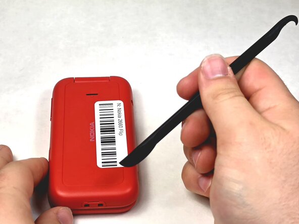

      • Turn your Nokia around to the rear side.
      • Insert a spudger or your fingernail into the notch on the bottom of the device.
