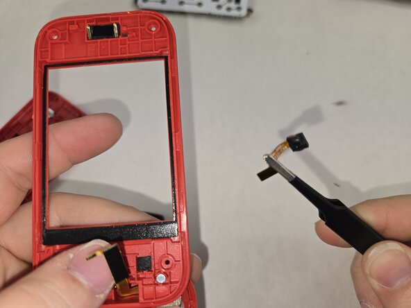

    1. Nokia 2660 Flip Camera Replacement, Camera: step 9, image 1 of 3 Nokia 2660 Flip Camera Replacement, Camera: step 9, image 2 of 3 Nokia 2660 Flip Camera Replacement, Camera: step 9, image 3 of 3
      • Use gentle force when disconnecting the ribbon cables.
      • Disconnect the ribbon cable for the camera if you haven't already.
      • Using tweezers remove the camera from its slot.
