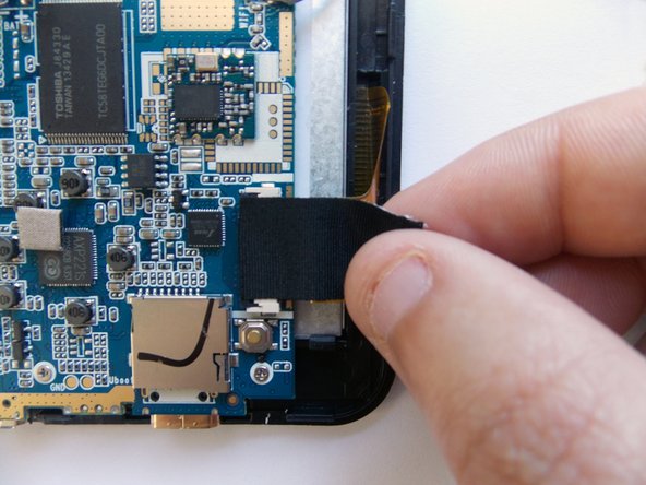

    2. Nobis NB07 Screen Replacement: step 17, image 1 of 3 Nobis NB07 Screen Replacement: step 17, image 2 of 3 Nobis NB07 Screen Replacement: step 17, image 3 of 3
      • Remove the black tape covering one of the screen power cables.
      Ask FixBot

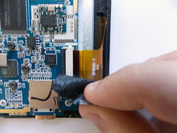

    3. Nobis NB07 Screen Replacement: step 18, image 1 of 2 Nobis NB07 Screen Replacement: step 18, image 2 of 2
      • Use the spudger tool to pry the ZIF connector upwards so that it releases the power cable.
      Ask FixBot

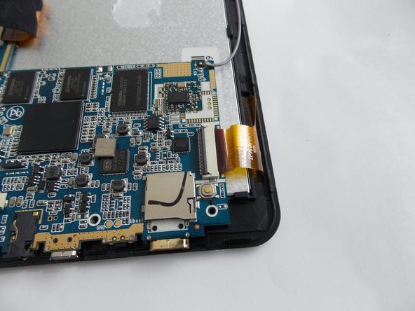

    7. Nobis NB07 Screen Replacement: step 22, image 1 of 2 Nobis NB07 Screen Replacement: step 22, image 2 of 2
      • Grab the now loose motherboard and move it to any side of the case.
      • There is still one cable connecting the motherboard to the screen. Since it does not hurts the process, you can leave it there until the end. If you want to remove it now, go to Step 25 and then come back.

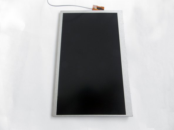

    9. Nobis NB07 Screen Replacement: step 24, image 1 of 2 Nobis NB07 Screen Replacement: step 24, image 2 of 2
      • Remove the screen from the case.
      Ask FixBot
    10. Nobis NB07 Screen Replacement: step 25, image 1 of 2 Nobis NB07 Screen Replacement: step 25, image 2 of 2
      • Remove the taped cable from the screen.
      • You can now remove the screen.
