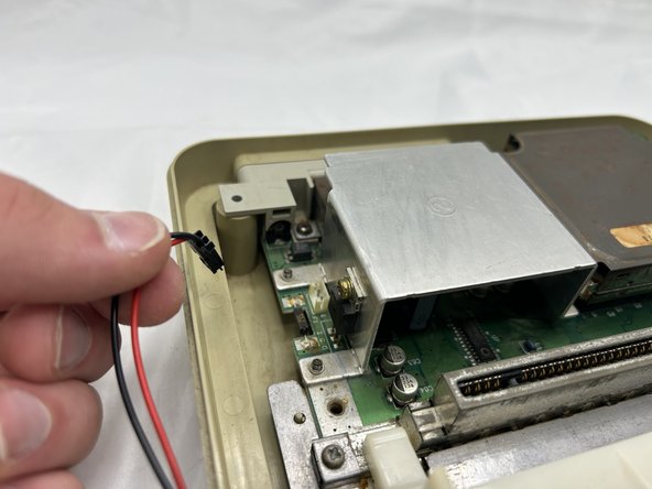

  3. Nintendo Super Famicom SHVC-001 Power Switch Replacement, Power Switch: step 3, image 1 of 3 Nintendo Super Famicom SHVC-001 Power Switch Replacement, Power Switch: step 3, image 2 of 3 Nintendo Super Famicom SHVC-001 Power Switch Replacement, Power Switch: step 3, image 3 of 3
    • Remove the two 15.6 mm Phillips screws that secure the power switch.
    • Pull the power switch motherboard connector straight out of is port.
    • Do not pull on the wires.
  4. Nintendo Super Famicom SHVC-001 Power Switch Replacement: step 4, image 1 of 1
    • Lift the power switch up and out.
