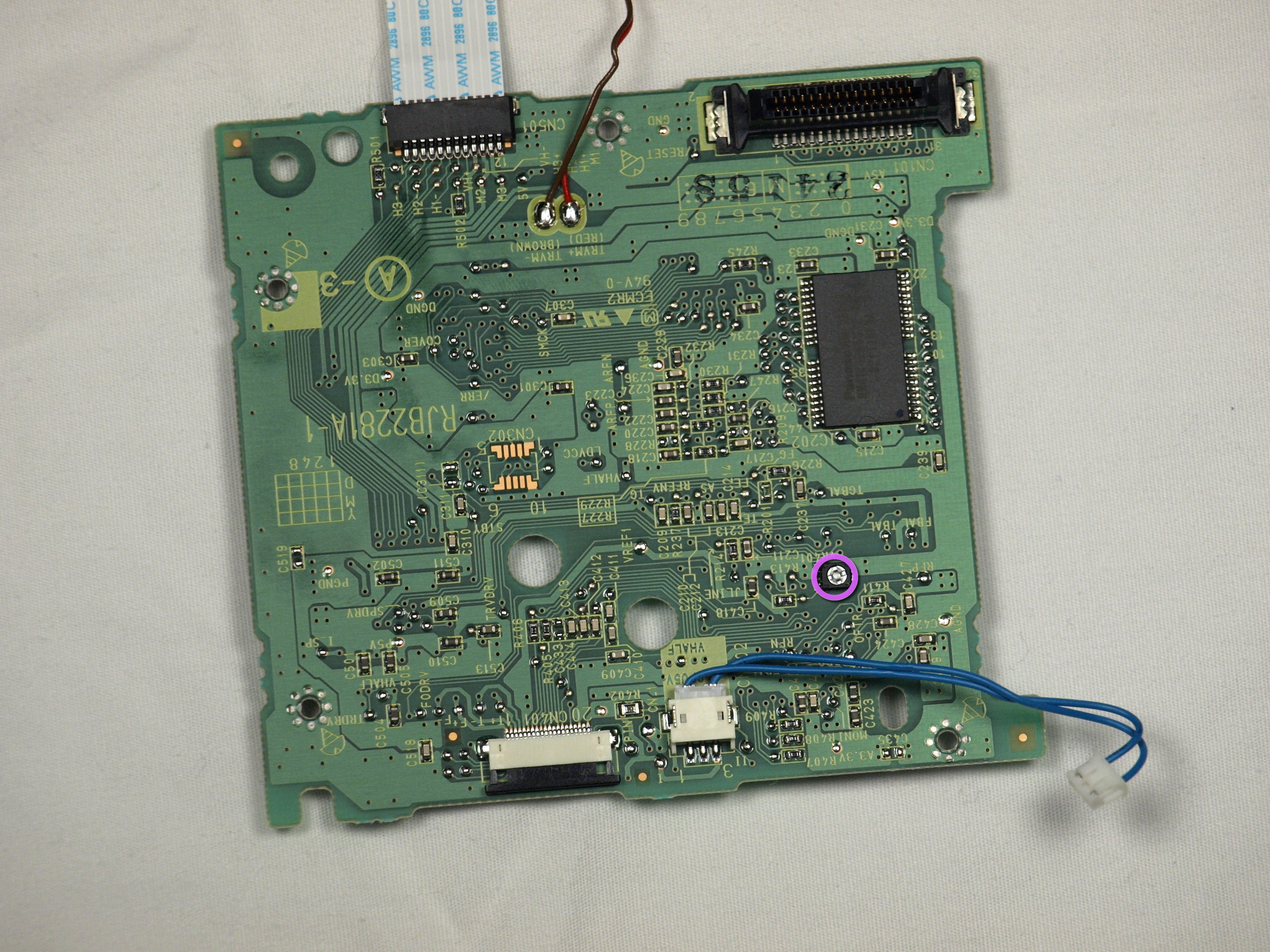

    9. Nintendo GameCube Lens Recalibration, The potentiometer: step 9, image 1 of 1
      • The potentiometer is located as shown in the picture. It's a very small cross-wing screw mounted on top of a little black box.
      • Now we need to adjust the potentiometer to make the optical lens laser stronger.
      • Using a very small flat head precision screwdriver turn the potentiometer no more than 3 degrees counter-clockwise.
      • Turning the potentiometer too much can result in the laser becoming too strong and actually burn the discs!
      • Turning the potentiometer clockwise would just result in a weaker laser and create even more DRE messages.

    10. Nintendo GameCube Lens Recalibration, Testing and further adjustments: step 10, image 1 of 1
      • To test the lens calibration reassemble the console up to the ground springs near the memory card slots.
      • The memory card ground springs MUST be put back on prior to restarting your console.
      • If any further adjustments are necessary just turn the potentiometer no more than 1 or 2 degrees more per readjustment. Eventually you'll start to see less DRE messages.
      • Once there no more DRE messages, turn the potentiometer a further 1 degrees to "future-proof" your lens from DRE messages in the future.
      • As stated in the title of this guide. This procedure may not fix your DRE problems if the faut lies elsewhere in the system. But this will cover about 98% of DRE messages.

Hi, is there a different measurement than 3 degrees? Don’t want to screw anything up, but I don’t really understand.
Claire - Reply Share
The 3 degrees is not an official measurement for this. But just make EXTREMELY small adjustments. Think of it like turning the hands on a clock. 15 minutes would be 90 degrees or 1/4 turn. So you can imagine how small these adjustments are.
