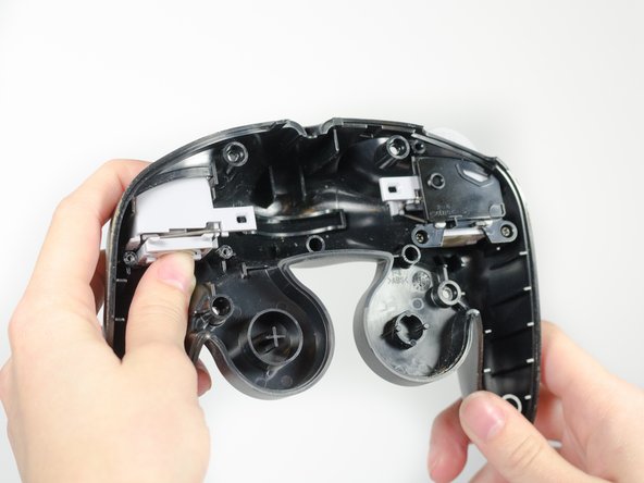

    2. Nintendo GameCube Controller Triggers Replacement: step 2, image 1 of 1
      • Gently lift the back panel up, separating it from the front panel.
      • Some of the buttons may fall out if they are knocked around.
      Ask FixBot

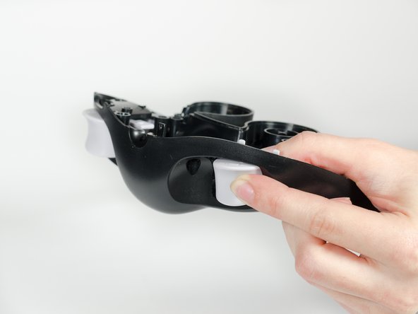

    1. Nintendo GameCube Controller Triggers Replacement, Z Button: step 3, image 1 of 2 Nintendo GameCube Controller Triggers Replacement, Z Button: step 3, image 2 of 2
      • Grab the Z-button by the peg with tweezers and lift it out of the controller.
      • During re-assembly, make sure the plastic rim and spring fit into the slot provided, or else the case will not shut.

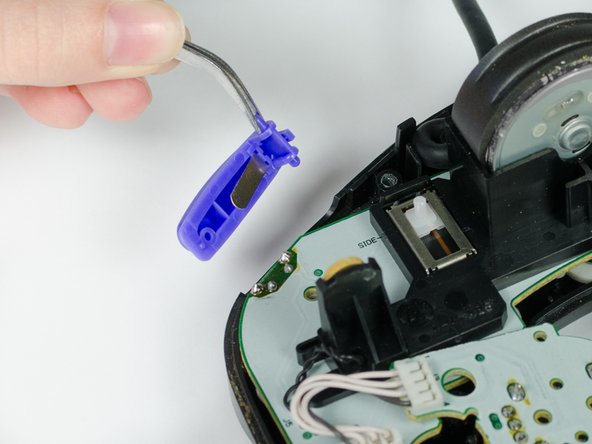

    1. Nintendo GameCube Controller Triggers Replacement, Circuit Board: step 4, image 1 of 1
      • Carefully unhook the cable that is looped around the peg.
      Ask FixBot

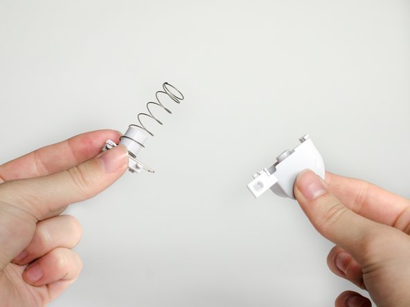

    4. Nintendo GameCube Controller Triggers Replacement: step 9, image 1 of 1
      • Pull the metal clip from the trigger.
      Ask FixBot
In order to remove the other trigger, simply repeat Steps 6 through Step 9 on the right side.
