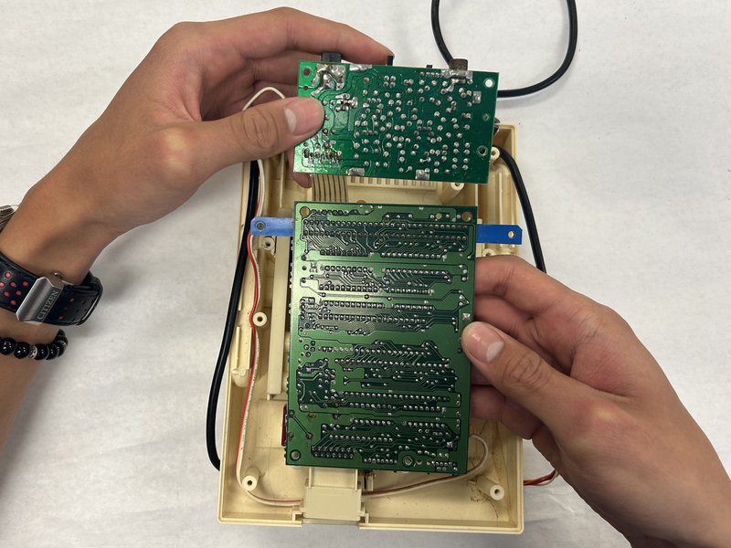

    4. Nintendo Family Computer (Famicom) Motherboard Replacement: step 4, image 1 of 3 Nintendo Family Computer (Famicom) Motherboard Replacement: step 4, image 2 of 3 Nintendo Family Computer (Famicom) Motherboard Replacement: step 4, image 3 of 3
      • Remove the eight 13.5 mm Phillips screws that secure the motherboard.
      • Lift the motherboard up and out of the chassis.
      Ask FixBot
    5. Nintendo Family Computer (Famicom) Motherboard Replacement: step 5, image 1 of 2 Nintendo Family Computer (Famicom) Motherboard Replacement: step 5, image 2 of 2
      • Remove the two 13.8 mm Phillips screws that secure the power switch.
      • The motherboard is connected to the power switch, and cannot be replaced without removing the switch. Forcibly removing the motherboard will only cause damage to the device
