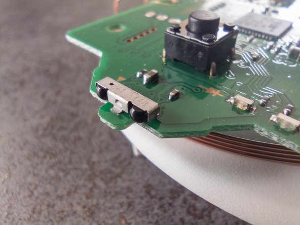

    4. Nintendo 3DS NFC reader exploded view, PCB analysis: step 4, image 1 of 3 Nintendo 3DS NFC reader exploded view, PCB analysis: step 4, image 2 of 3 Nintendo 3DS NFC reader exploded view, PCB analysis: step 4, image 3 of 3
      • The PCB consists of a microcontroller unit of unknown reference and a Broadcom BCM20792 KMLG NFC controller.
      • The IR transceiver is made of 2 parts, likely one dedicated to receiving and the other to transmitting.
      • Two LEDs are present to indicate the communication status to the user.
