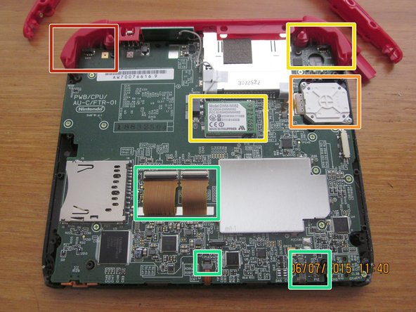

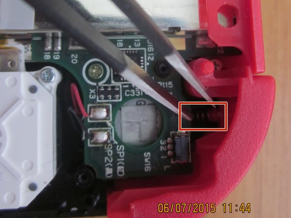

      • Gently lift off the coloured frames on the sides.
      • Remove L&R triggers
      • I recommend using tweezers to push back the spring so allow easy lift and placement.

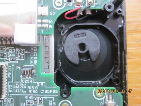

      • Remove circle pad module.
      • Remove wifi module
      • Unseat the ribbon cables.
      • 2 big ones mid board, 1 center bottom edge, 2 Bottom right corner.
