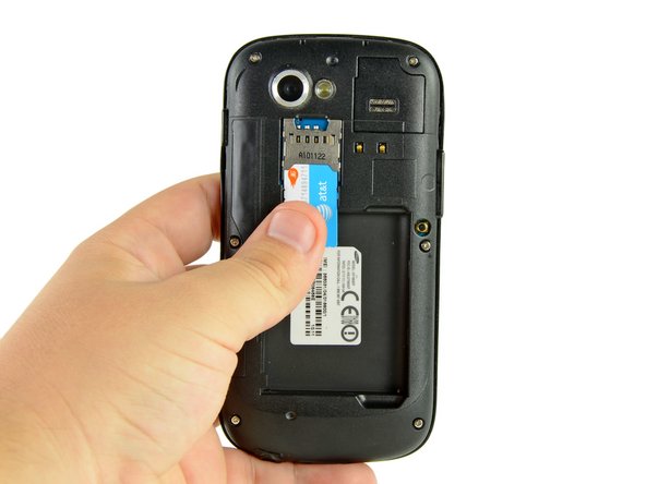

    1. Nexus S SIM Card Replacement, SIM Card: step 4, image 1 of 2 Nexus S SIM Card Replacement, SIM Card: step 4, image 2 of 2
      • Use your thumb to slide the SIM card downwards from the SIM card slot.
      • Remove the SIM card.
